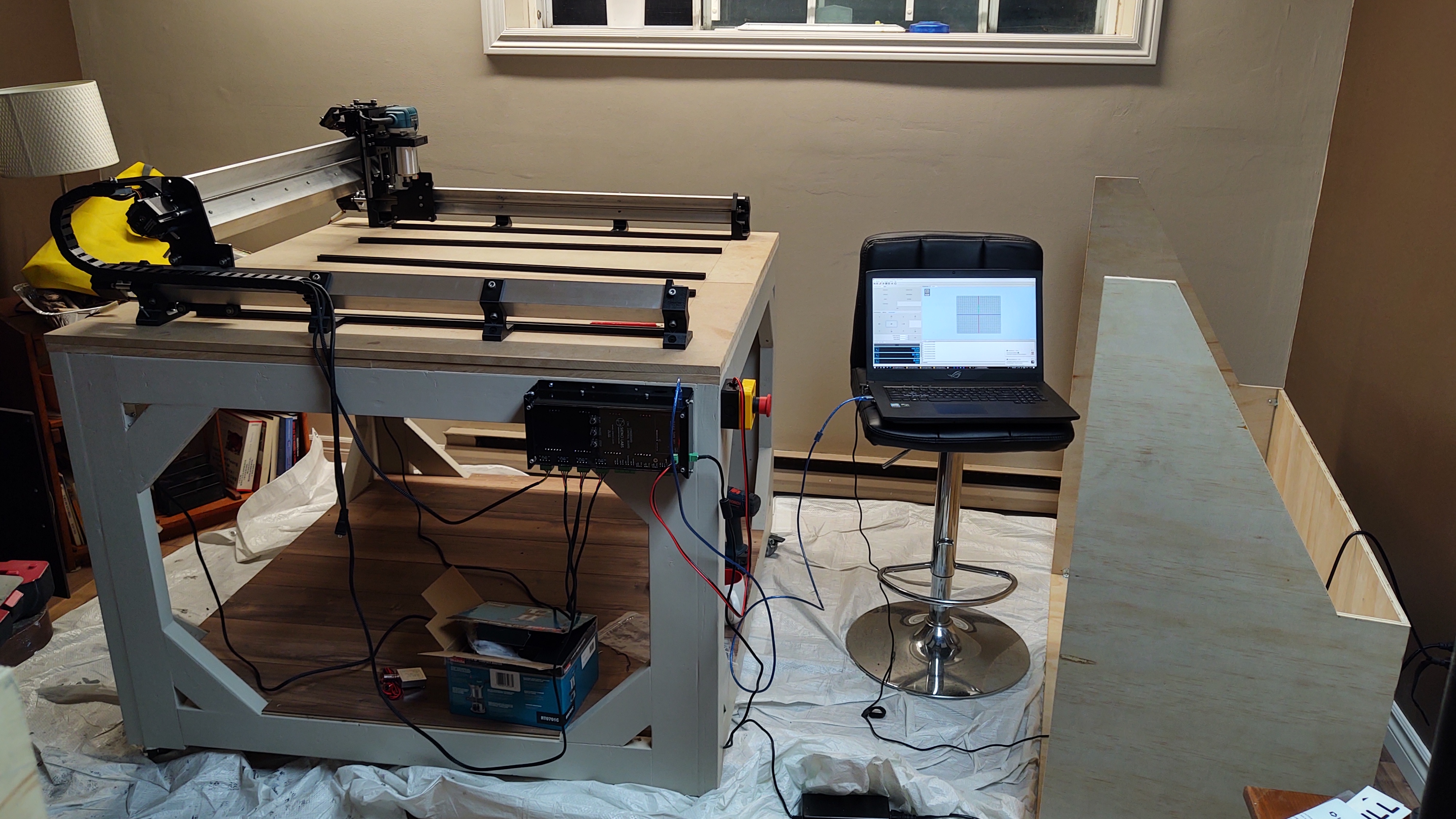

Robert, I wanted to compliment you on your shop that I have seen in pictures you have posted. Very nice! I was very interested in your table that you built to house your LongMill. Do you have any plans or dimensional info that you would share?

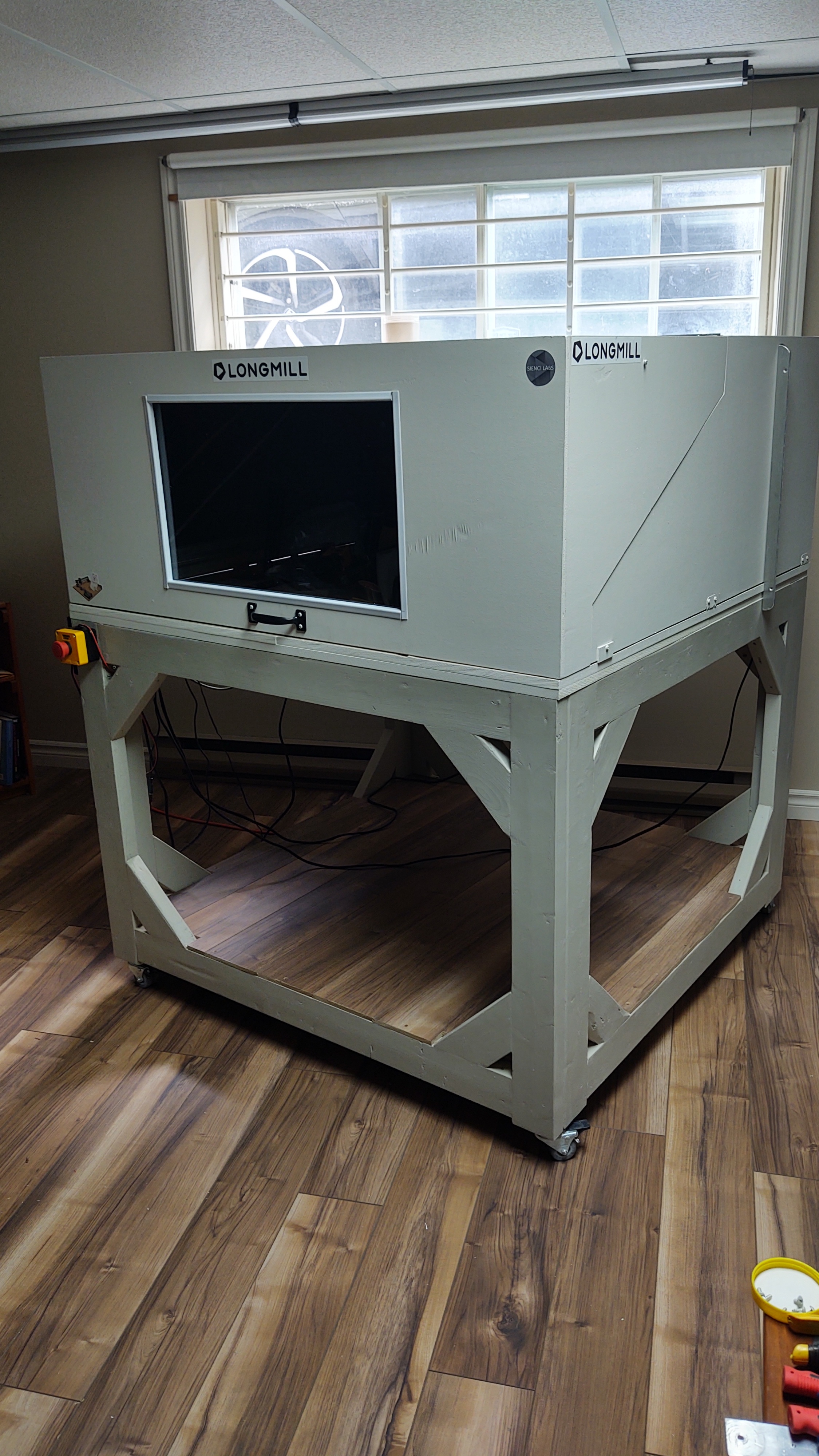

Hey Gary how you doing I really have to apologize for not getting back to you sooner just been swamped here no sorry I don’t have any plans the table was all done off the top of my head I would be happy to take some measurements for you if you’re interested the table is completely made out of 5/8 MDF as you can see it it all has a grid of crossmembers underneath the table I believe off the top of my head is 48 wide by 52 long since building it I’ve had a steel angle iron frame just for some more rigidity to the table I’m working on a hood for it right now little flip up from the front and open up in the back for longer projects I appreciate your comments if there’s anything you need to know don’t hesitate to ask.

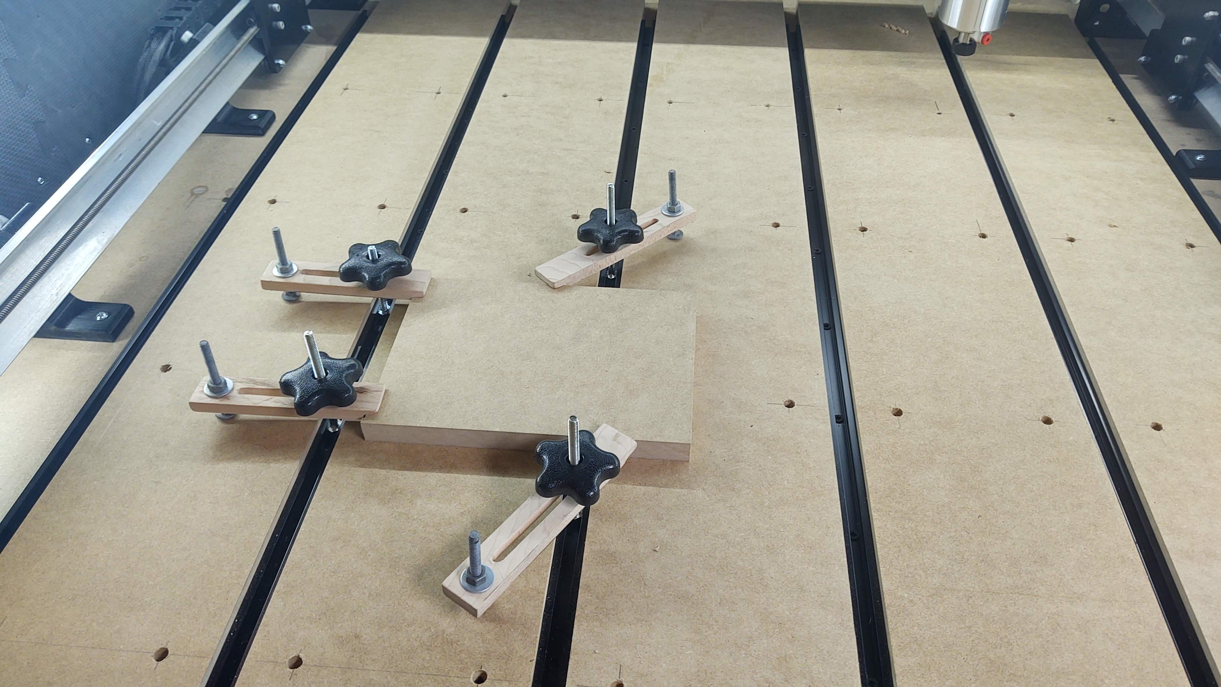

sysimgrp - I was very impressed with what you came up with for clamping and your tabletop. I’ve ordered my machine and expect it sometime early October. I’m trying to decide what my hold-down system would be. Had I not seen your video I would have gone the t-track path. I may still go that way as I have built many jigs for woodworking with that approach. I’m now contemplating a hybrid of what you presented with a t-track variation. I very much like what you have presented. Kudos to you.
Now some questions: Is you board replaceable without removing the CNC? I could not tell from the video. I was thinking of elevating the machine rails on 3/4" thick MDF strip to accommodate the rail support and then having my spoil board sitting between the rails. That would make replacement easier and if I am not being naĆÆve raise the z-axis cutting height to allow cutting/shaping larger stock. Last question - the video looks like metal reference parts on the lower left corner for x and y calibration. What are they made from? They look like the edges are bent. Where did you get those? I planned on mounting something like that. I just figured I would use wood. Your choice would be more stable. Your system eliminates the need to worry about expansion or contraction with seasonal weather changes in humidity.

Chris - the video in my post is not me or of my setup. It was something that I had seen that I thought was interesting and thought others might think so too. There are some stills of my setup in my posts. I use a combination of t-track and dog holes. I find that I mainly use the dog holes with the Kreg clamping jig.

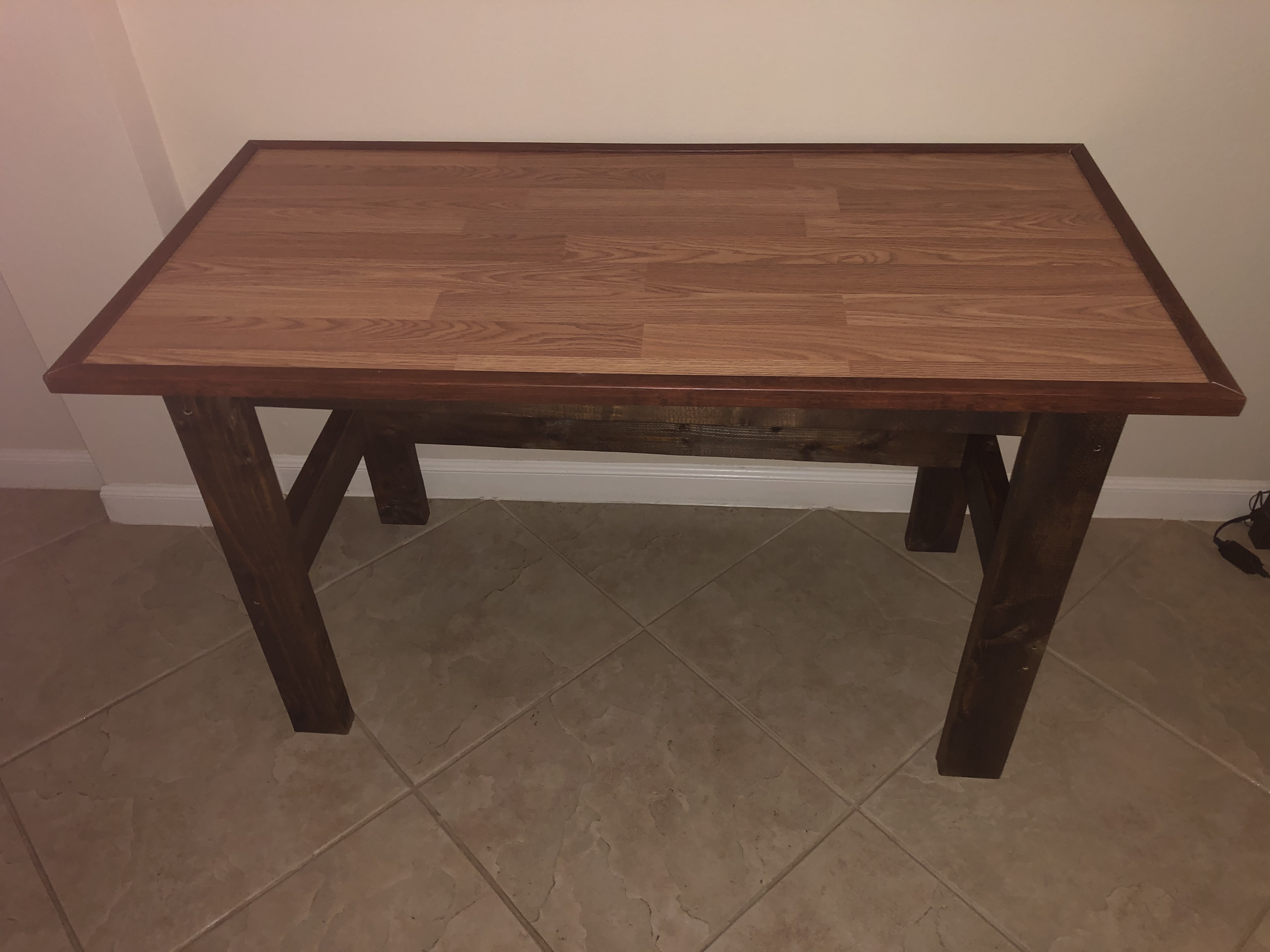

I’m making 2’ X 4’ School desks for a non-profit. There wanting 12 desks. I have built 4 so far. Currently, the second most expensive part other than the 2X4s is the trim. Which is running $7.50 per table, the top is Wood Plank Laminate Flooring which runs about $4.00 per table. With the Long-mill it will cost me $2.00 per table to make the trim. Here is one of the completed tables with the colored PVC store-bought trim!
The second photo is showing a completed corner trim printed on the Long-mill. IMG_0777|666x500

Rob I intend to follow your general concept for my table. I plan for my table top to be 47 7/8" square to accommodate saw kerf when cutting 4’ X 8’ sheet in half. It appears your legs are 1" X 6" nominal lumber. This also seems to be the case for the horizontal pieces that support the MDF top. What did you use for the grid crossmembers that support the MDF top? I an interested in how that is arranged while allowing for the space for the drawers. I really hope that you can provide me with this information. Also how tall did you make your legs? I am pretty much limited to my electric scooter for mobility and do little while standing due to poor balance. We adapt! Mine will probably be shorter than yours. How are you coming on your enclosure? I plan to have one also. I am thinking about splitting the top and sides about 2’ from the front face, hinged across the top from left to right. I am thinking I will add 1" foam board on the inside to dampen sound and add LED light strips. Note: As of today ~ # 90 in the QUE > Regards, Gary Cooke from the burbs of Houston, Texas

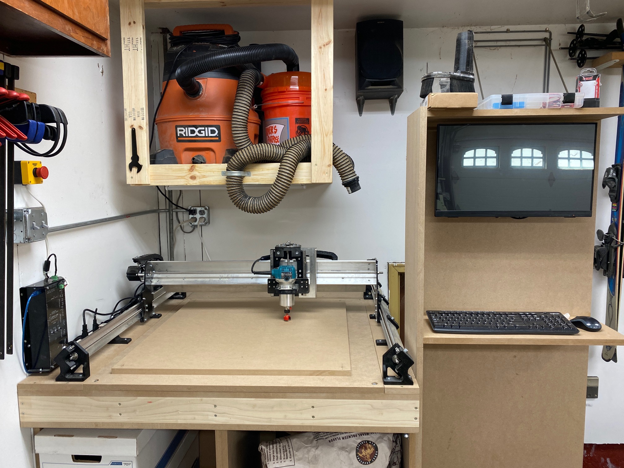

Hi all, figured I’d add another example to the chain.
My garage has a set of stairs going down half a level and left me with almost a perfect 4x4 corner.
Wired in two switches, one to power on/off the mill and the other for the dust collection. Added a light under the shelf also run on the switch for the mill so I can tell from across the room if its on/off.
Cabinet is MDF, torsion box top with an replaceable section (2 layers MDF) so even when I screw up depths, it can’t cut into the torsion box. Since this picture I’ve added a bunch of threaded inserts for clamping and am taking inspiration from others in this forum to make clamps/holddowns next.
Found a dust separator lid for 5 gallon buckets at HD. Pricy, but seems to work well.
Under cabinet area will be boxed in with doors (with something carved on the mill) later. Only used about 2’ depth. Another opening on the right side allows me to store lumber (4’ or under) which has helped keep things organized.
