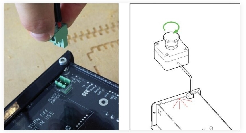

Hi Mike,
The long board has a two wire connection to connect a emergency switch to. It can be anything from a light switch to a regular emergency switch with a big red button as long as one of the contacts is a normaly closed one that stays closed while the switch is in that state and becomes normaly open when pressed or switched and stays in that status untill unlocked or switched again.
The longboard has no function keys included in the emergency button. Some function keys are included in the unit itself though. I do nkt believe they are programmable, like the funtion keys one the slb emergency button.
Good news is, that you can source a simple emergency switch from anywhere without breaking the bank.
The wiring is straight forward, since it’s a switch that does not have polarity, wire the emergency switch to the lb top con ector. If it does not have that connector, you might have the longboard gwilki ks talking about.
If needed you can short the connector with a wire to simulate a emergency button in its active state without needing a actual emergency button. One could choose to indeed have an alternative way to shut the machine down, like I do -besides having an emergency stop- I am able to switch off the power to my machine via a switch in my office, including the router.
The emergency stop button connected to the longboard will not address the router, leaving it running while you have an emergency. This was not an acceptable safety for me, so I added an extra safety switch (light switch) away from the machine to have a way out safety besides the standard red button at the machine. (Some situations leave you not wanting to approach the machine to press a button tnat will only disable part of the machine.)

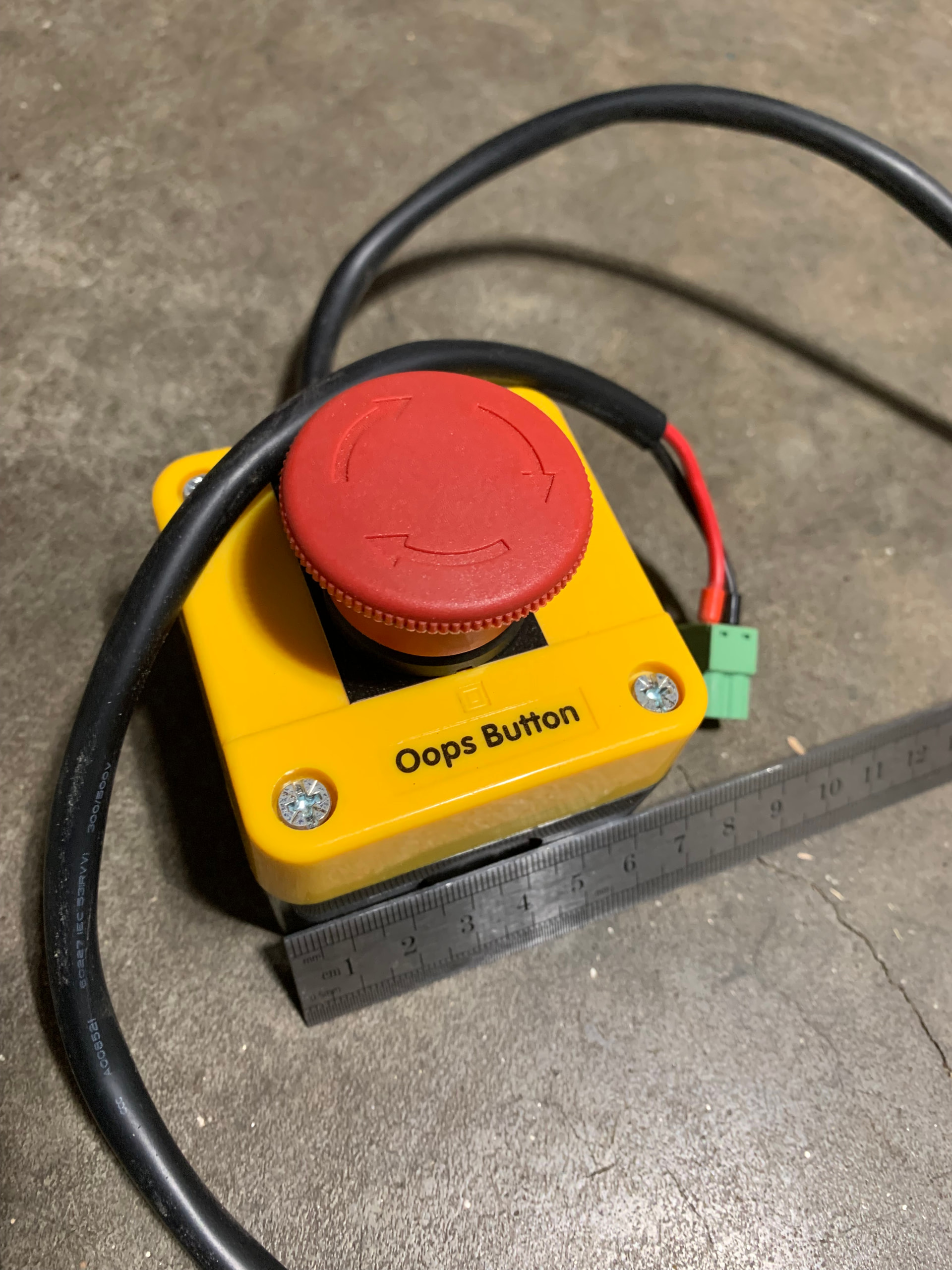

I have a LongMill 30x30 V4b. It was the last model before the Mk2 came out. It came with this Oops Button and the regular LongBoard.
If you have to do the wiring yourself the green connector has 5.08mm pitch like these on A.
AMAZON.COM have same e-stop buttons, I need to replace because one of my guys overturned and find at Amazon this model, exactly same that original: *
APIELE 22mm Metal Emergency Stop Push Button Switch Latching 12V-250V Stainless Steel 7/8" Mounting Hole B Type
