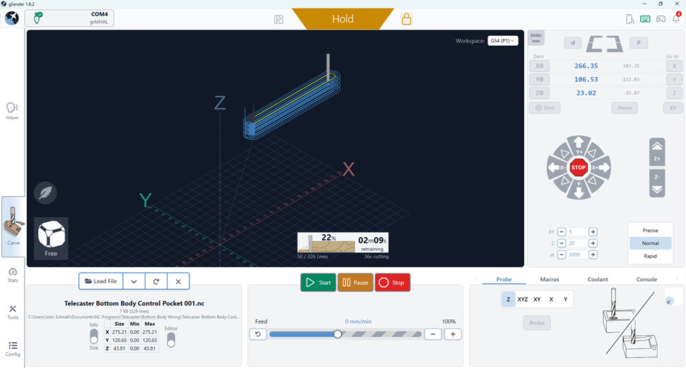

While running code gSender goes into 'Hold' and can't recover
I’ve updated from 1.5.6 to 1.6.2. When running any code it would ā€˜Hold’ and can’t be recovered with any buttons. Emergency stop then start at a specific line allowed it to continue. Even occurred with surfacing code generated by Tools. Continued to freeze at the same code line after 3 separate tries.
Reverted back to ver 1.5.6 and code worked fine. Occurred on 3 different code files. I like the new features and would like to upgrade :slight_smile: .

Your connection widget shows you’re connected as grblHAL - go into Config and swap the fallback firmware to grbl instead of grblHAL (inside the Basics section, right at the top). That should fix your issue.
Tested and all is good!
Many thanks…john
