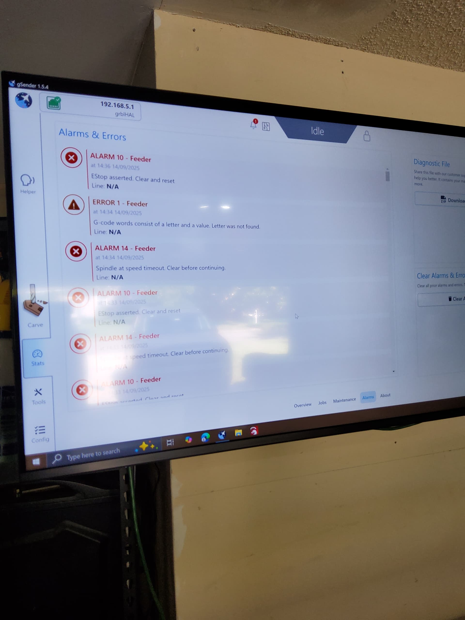

X axis auto movement causes alarms
Just finished building my Altmill Mk2 4x4, homing works fine, jog buttons work fine, but if i try to use any auto movements that moves the X axis to the right; it does a rapid movement (no matter what mode it is in like, precise, normal, or rapid), and set off alarms 10 & 14. I found this out when trying to use the X Y squaring tool and testing the quick travel buttons, any other movement works great,
Solved, after a few hours of playing in the configuration section, I also noticed my steps where way off on the X axis, I’d set it to move 300 mm, and it would only go 120 mm, I double che ked my X stepper motor and the number 3 dip switch was in the wrong position, once I corrected that, everything worked as it should.
