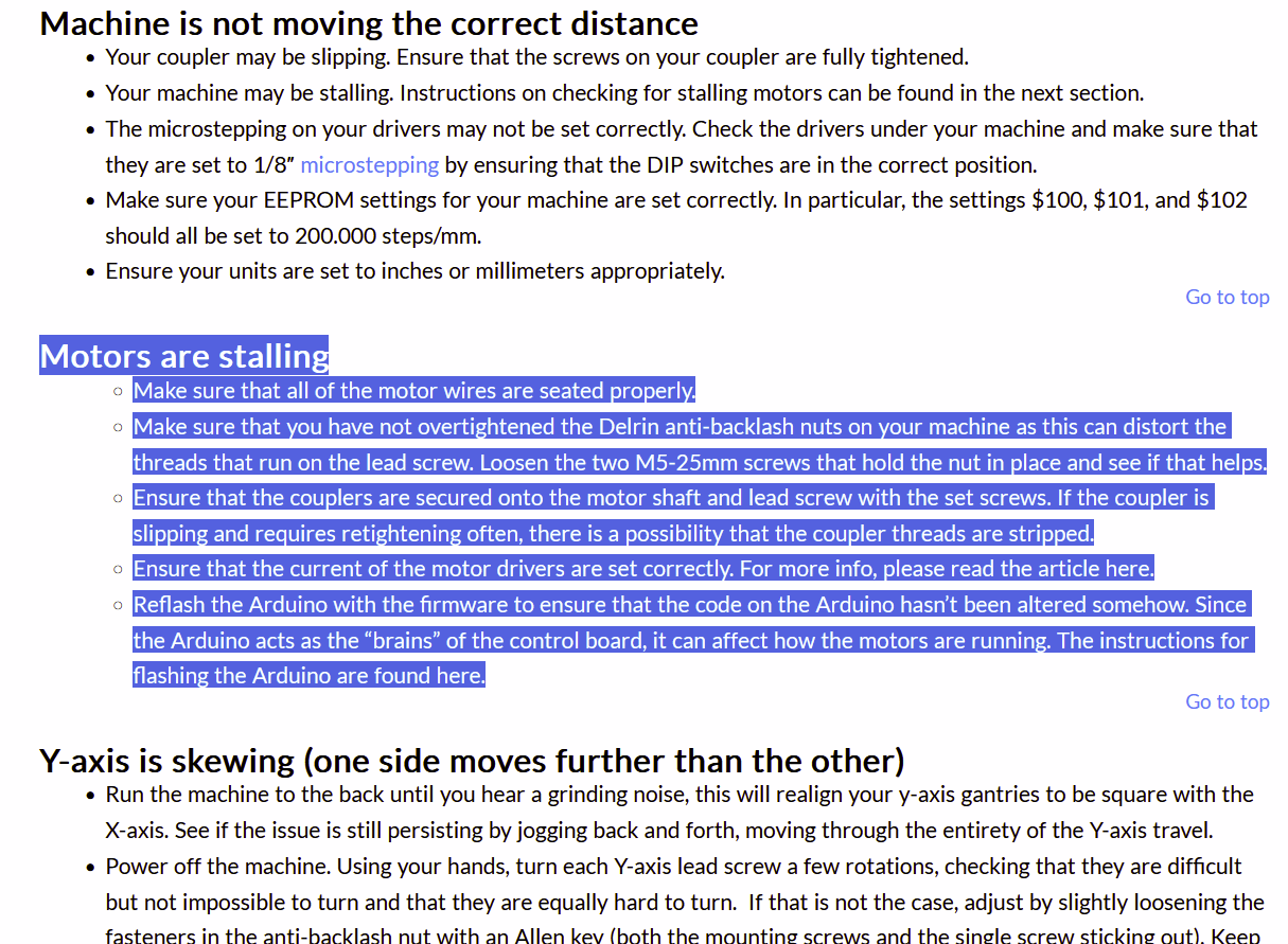

I just received my LongMill Mk2 30X48 and have assembled it and adjusted everything. I thought I was all good and was ready to start on my spoil board, etc.
Then I noticed that while the X-Axis jogs fine by itself, as does the Y-Axis, but when trying to move diagonally, the X-Axis stalls.
Does anyone know what might cause such a symptom? It seems like the X-Axis is not getting sufficient power when the X-Axis is moving, but I don’t know what I can do to resolve.

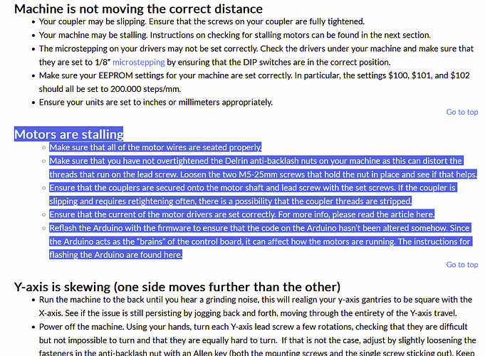

On your problem there’s this cutout that you might find interesting checking on:
You can find this info here.
Though it is frustrating to have a hickup, the troubleshooting is not something you stand alone in. If you can’t tackle the problem using the elaborate sienci library, you can always open a ticket and get backup from the smarts at sienci.
