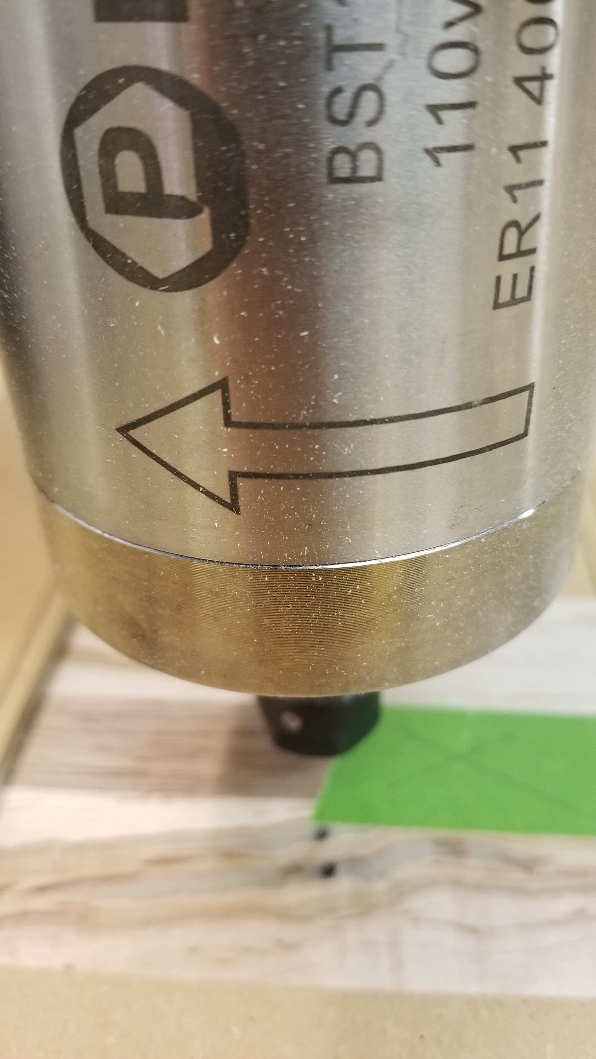

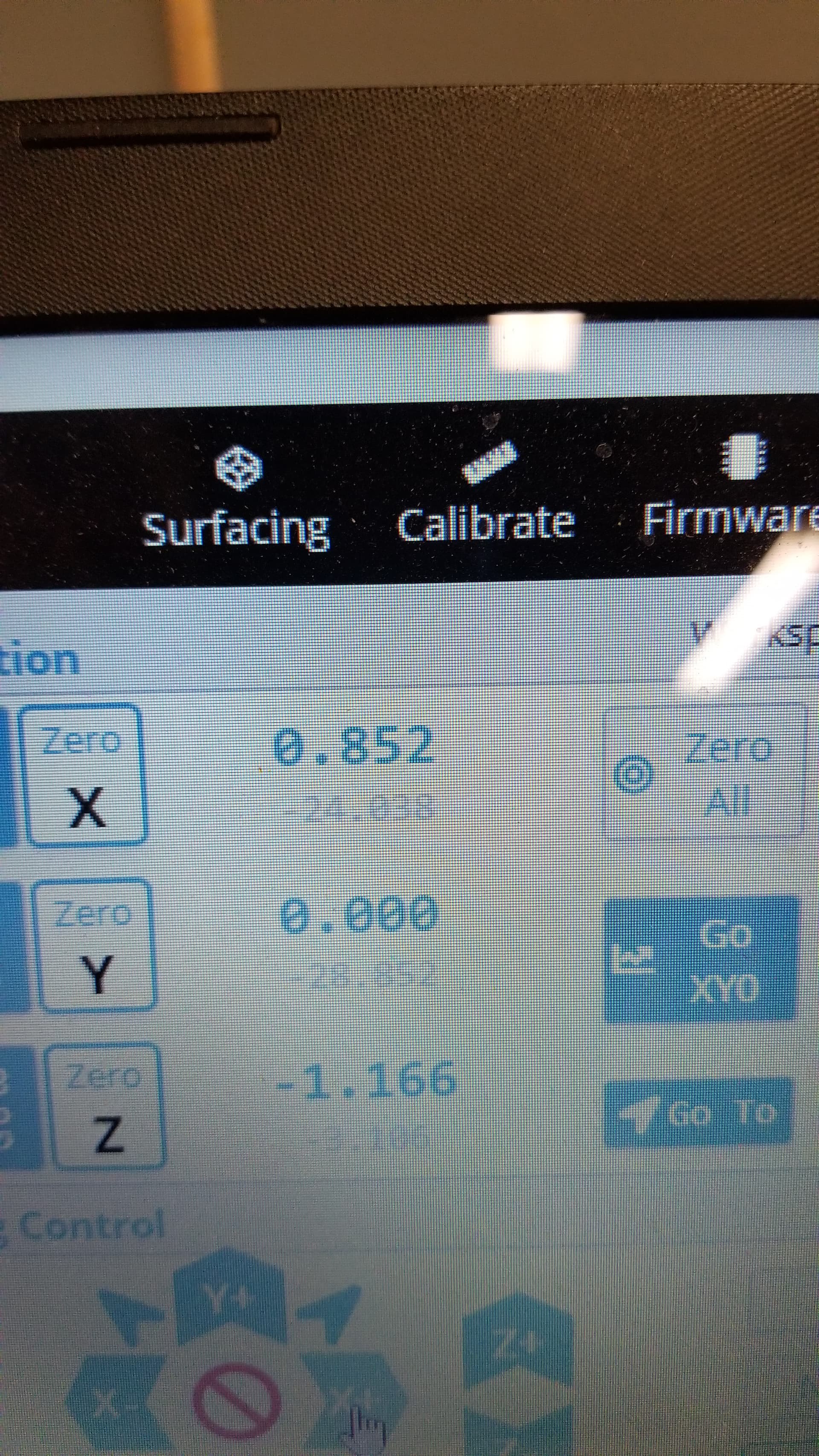

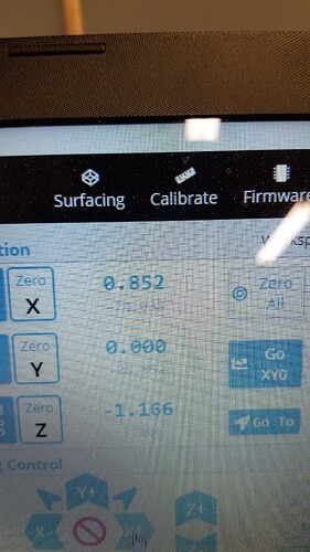

I tried to run a project without the bit to see what will happen and it seems that when the X motor starts it skips and throws the whole carve out on the X axis. I moved the board to a new location and the same thing is happening.
the first pic is showing off center, the next pic is how far off X0 it was
The lead screw turns by hand with no problem, the bolts are all snug, and it doesnt happen all the time. Sometimes it’s ok after homing and sometimes not. Not sure if the move to the longmill was a good move.
