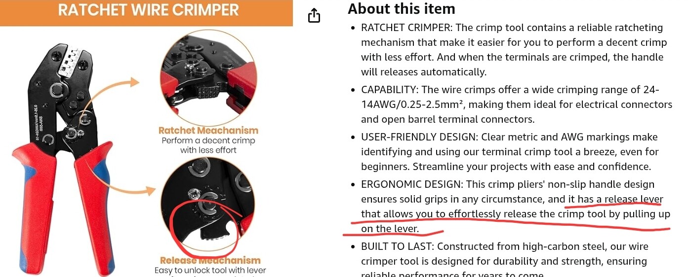

You can crimp them with small pliers if your careful but it’s a real pain. A wire crimping tool like this is the correct way to crimp them. Those crimpers have a ratchet mechanism with 3-4 positions so you can put the pin in the crimper and go 1-2 clicks to secure the pin then insert the wire and finish crimping. They wont release until fully squeezed. The is no backing up so you might want to practice a bit to get a feel for it. Then when the pin is crimped to the wire it is inserted into the connector and it locks inside.
Most if not all of these crimping tools have a release mechanism that can get you out of a problematic situation. The tool you linked at does so too.
Haha! Correct again sir! I have two pairs and they both have that release if you know what your looking for and now I do. Apparently there are still things left for me to learn, who would have thunk it…
