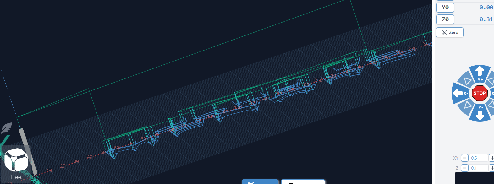

Once I click carve, the spindle goes so high it hits the limit switch. If I unlock and continue, it raises higher and goes through the toolpaths. But its about 4 inches above the piece. I zero in when the bit is touching the work piece. I have the Safe Height under Basics settings set to 0. Z axis under Homing is set to 22mm. Foxalien Vasto is the machine.

Thanks for this info Karver_One. I validated these settings in Vectric Vcarve Desktop. Still wants to jump up. I ran teh $RST=# cmd. I verified the safe limit is in mm. Made sure the Rapid Z-Zero Gap is set to .2 inch. The Gap above piece setting is set to 0. The z plunge (z2) and Clearance (z1) are set to .2 inch. Before getting Vcarve, I used Easel and made a couple successful carves. Which indicates the machine is good. Under config changed the machine type to Generic CNC. Starting to thing gsender doesn’t like my setup. I just noticed the start and some other point, the z motor is hitting high. Below shows this. No idea why.
