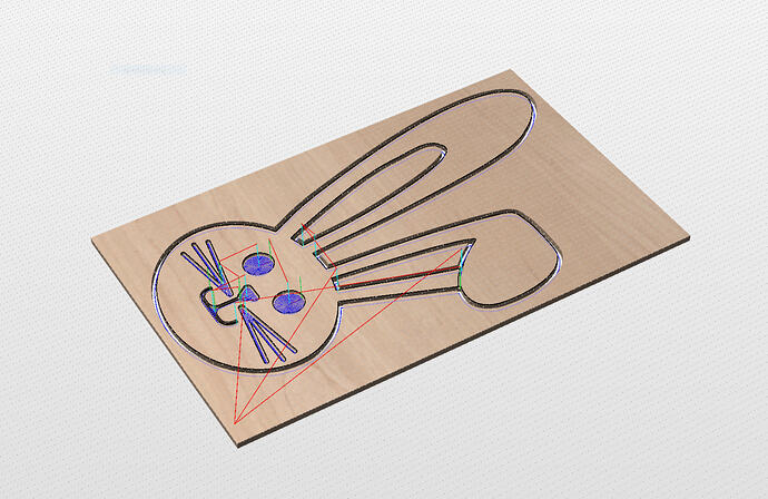

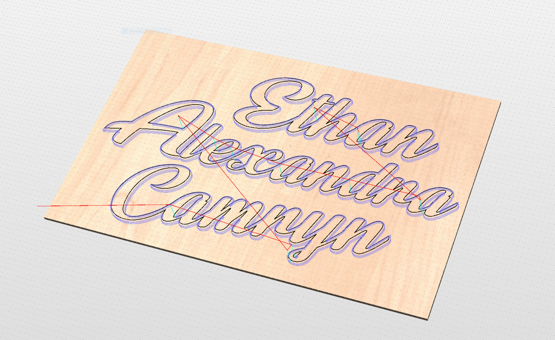

@DaveChevalier Does it appear to behave like it should? It does to me.
Put the spindle at a random location and then run the job. Note the z it goes to as the spindle moves to xy0. Then as it goes to your start point. Then as you start the job (which you did already). Everything should match what you defined in Aspire.
This is interesting. Are you in Rotary Mode? Not sure if that would affect this but since two updates ago it was suggested I believe to be out of Rotary mode load the default Longmill MK2 config and have no A axis showing on gSender.
Done.
Z up 25.4mm, moved to start point, Z -3.30, air job running.
In Aspire, I have the cut depth at 0.13in (3.30mm) and the safe height to 1" (25.4mm)
Just checked, on the Rotary tab the toggle is on 4-axis mode.
@DaveChevalier Looks like it’s doing exactly what it’s supposed to, right?
