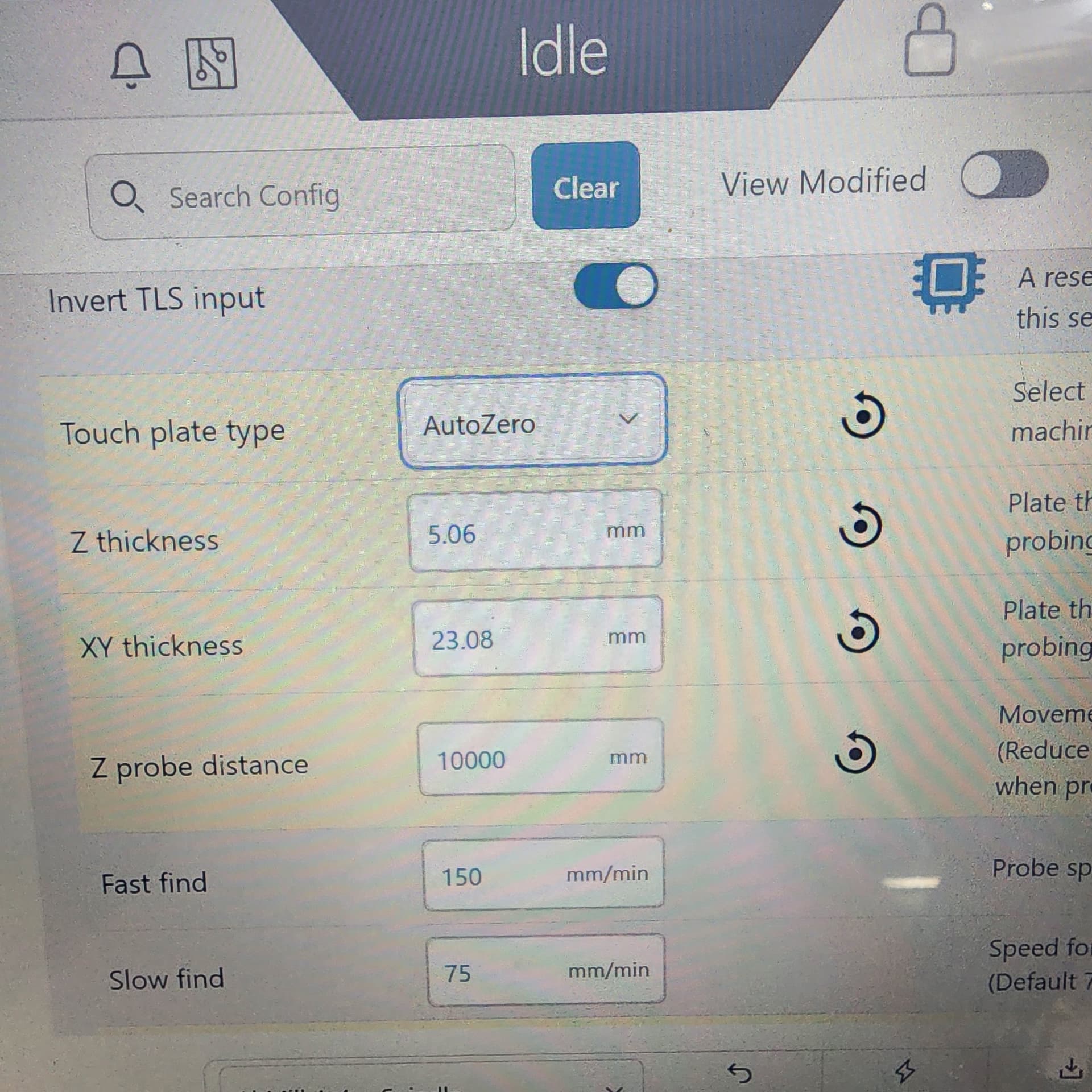

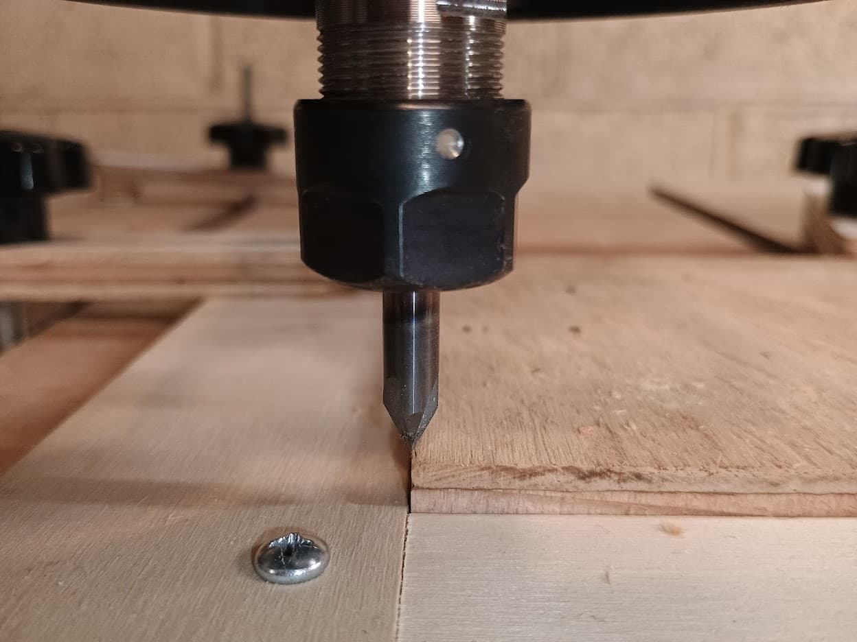

Hello everyone. My Auto Zero Touch Plate is approx. 2.92mm off on y axis and 2.85mm off on x axis. I have messed with the probe configuration in gSender 1.5.2 , but its still off. how do I fix this? So far, changing the xy thickness in gSender has no effect.
@EADURB I don’t have a solution, but I do have a question. Are you following these instructions
You’ll also have the option for choosing which tool you’re using, either “Auto” or “Tip”. Auto measures the diameter on straight end mills and bits. On the other hand, Tip uses the tip of v-bits, tapered bits, and ball nose bits touching against the bottom chamfer to determine its position. Using the correct setting will ensure the most accurate probing for your bit.
I noticed the same thing after updating to 1.52. I haven’t run any jobs that it mattered though. I just ran a zero with a defined 6.35mm bit.
I have the same issue. I’ve been trying to do 2-sided carves and it’s not currently possible.
I just have a 5” square blank that I’m putting a 4” wheel in with a recess for a bearing, and it’s clearly not centered. It was off by 1/16” when I was using gSender 1.5.2 - I downgraded to 1.4.12 and it’s off by less, but still off - about 3/64”.
I’m using the option where I tell it the bit is 1/8 / 0.125” and doing XYZ.

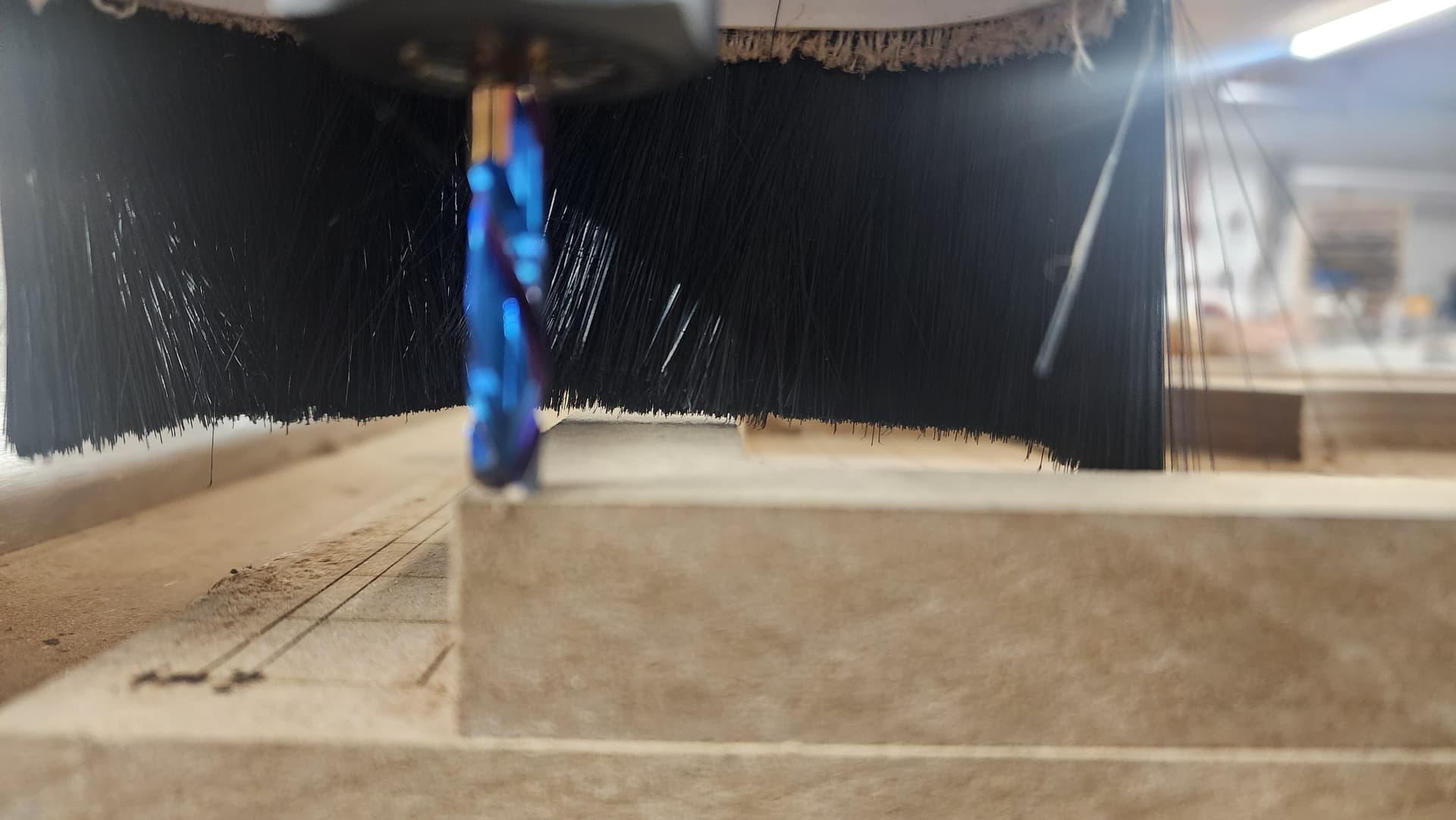

ETA I also noticed under gsender 1.5.2 it was zeroing as in the photos - with the bit over the work, as opposed to zeroing with the center of the bit on the corner.
It seems like it’s not doing this in 1.4.12 but it’s still off

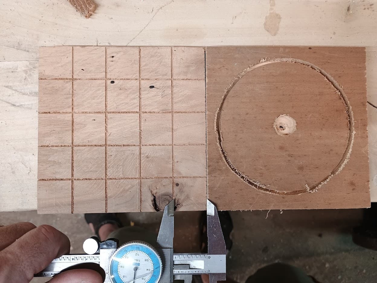

I can’t make a wheel if the bearing axis is off by 1/16 side-to-side, not even for this toybox
The photo shows the wheel I’m trying to make & you can tell at a glance it’s not even close to centered.
It also shows a test cut I did with just a 5x5 grid about 0.05” depth, and it’s dead-nuts on.
I shaved both blanks until they were both 5.00” ± 0.01”.
The differences between the two:
  1. I modeled the wheel in Onshape and generated gcode using Kirimoto. The wheel is also cut out using a 1/8” bit (upcut, which is why it looks terrible) which was zeroed using the 1/8 bit option and XYZ.
  2. I did everything for the grid prior to gsender in Easel, and the tool is a 60 degree V, zeroed using tip mode.

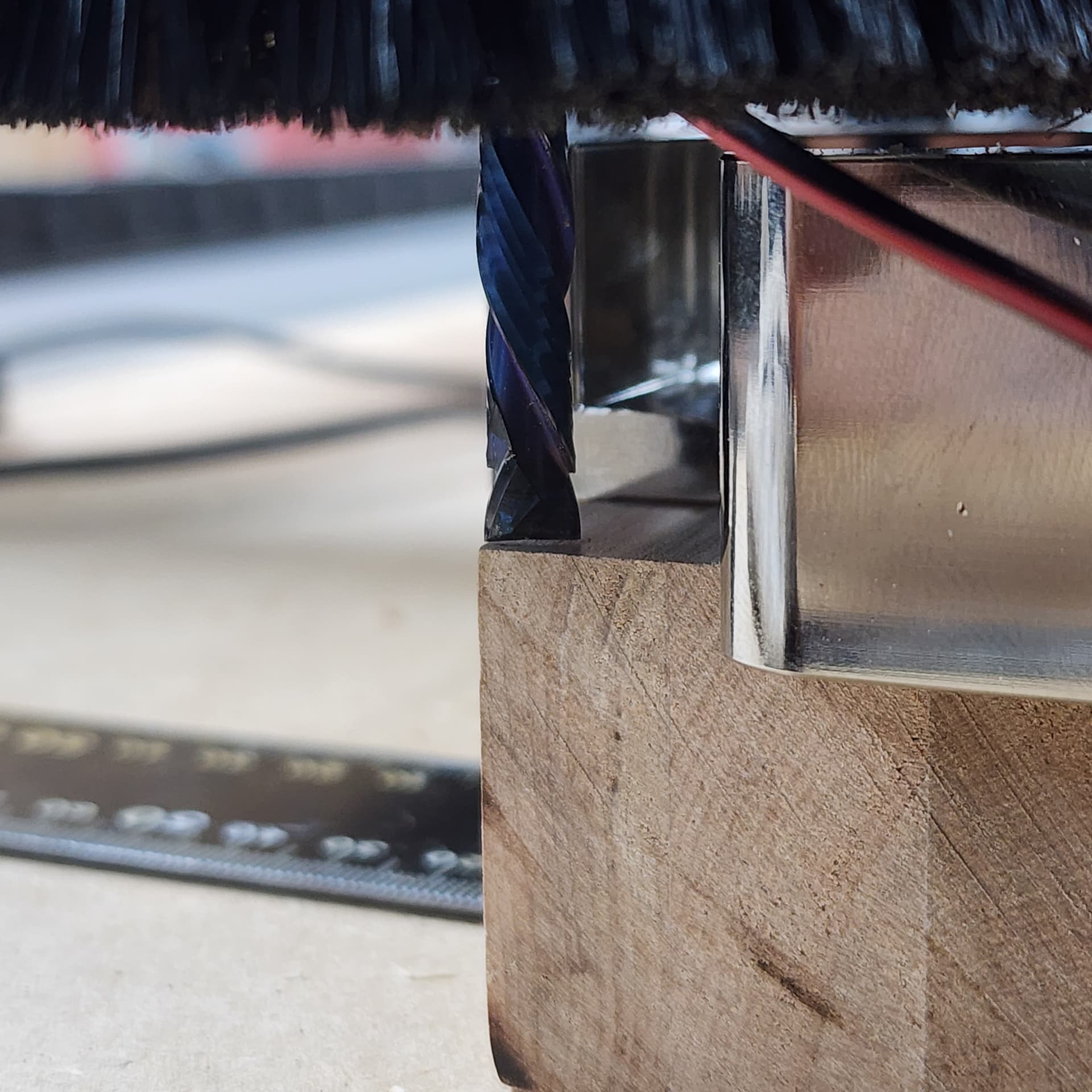

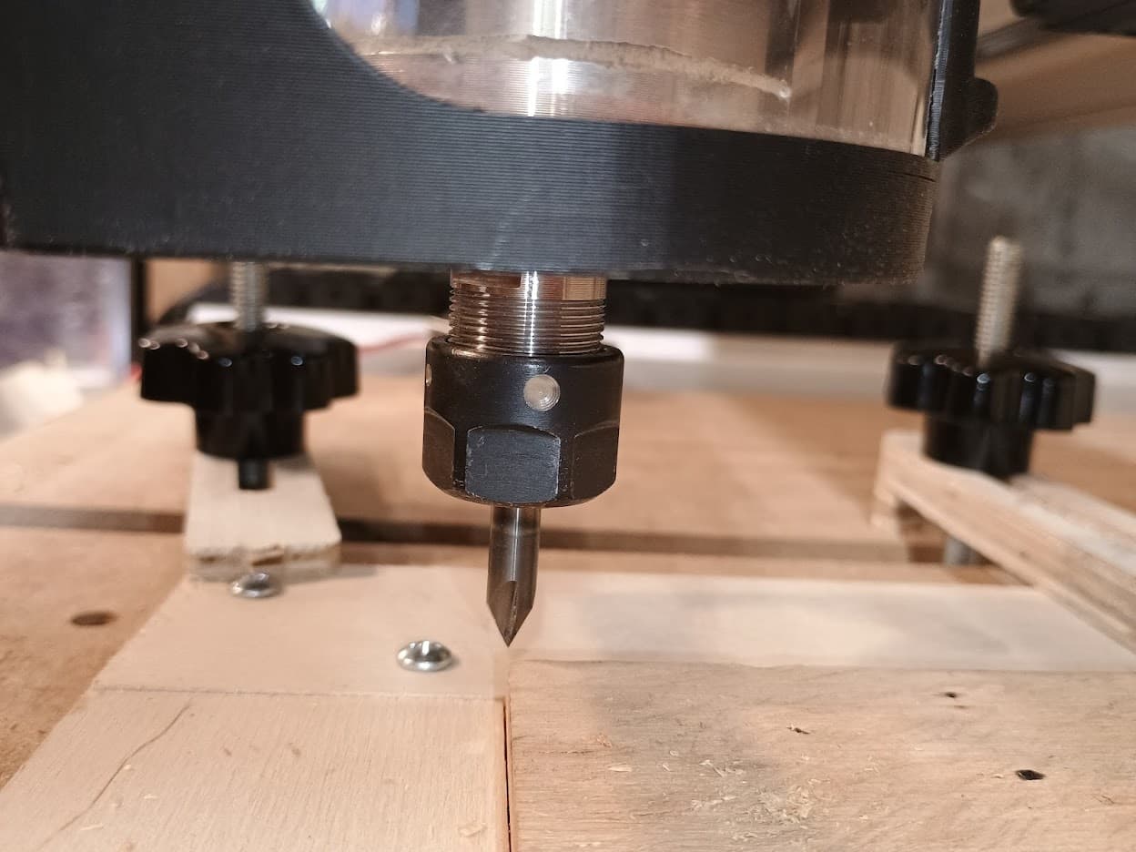

BTW this is how mine zeroed:
tl;dr I don’t think I have an issue with zeroing - I could swear the 1/8” bit was over the work last night but this is what just happened using gSender 1.5.3. Mine is probably a gcode issue.
If this was my support ticket I’d ask the previous reporters to test with a v bit & see what happens.

Well I was assuming the model is going to be in the center of the piece - and as far as I can tell, it’s supposed to be in Kirimoto.
I have a square L-shaped brace clamped to my spoilboard which I made sure is aligned with my X&Y axes, and, provided the workpiece is centered, I should be able to zero to the piece when it’s clamped next to the brace, then flip either way - and therefore skip using dowels.
Everything checks out except for the cutout not being centered as advertised. I only initially thought it might be an issue with the autozero plate.

I believe I found the issue.
I used zero method ‘tip’ and it was fine.
I used zero method ‘auto’ and was able to do 2-sided cuts just fine (a little misregistration, but that’s my clamping method).
In my case I was defining the bit as 0.125” and it was off on the X axis by 3/64-1/16”. I verified last night that when I zero it using defined bit size of 1/8” it’s zeroing with the entire bit parked on the material as in Kerryh2012’s OP.
Kerry is also using a 6.35mm bit and says he’s off by 2.92mm - which is pretty close to half the bit diameter.
The issue seems to be defining the bit diameter in the zero process. It parks the entire bit diameter on the work as in the initial photos, and therefore the entire carve is going to be off by 1/2 the bit diameter. I literally watched it do this last night between defined bit diameter and auto methods.
I’m not sure if there’s a way to examine the instructions gsender is sending to SLB between the methods
 or if there’s a place to make official bug reports? But for now just do the 4-touch auto method, spend 30 extra seconds and it’s probably fine.

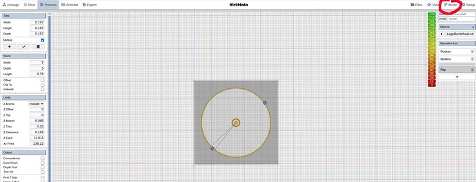

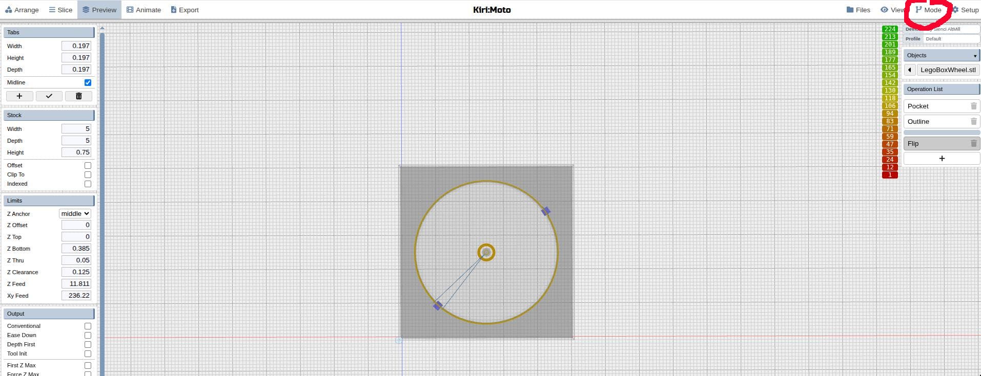

By the way, yes Kirimoto is a 3d printing app - that has a CNC add-on. It’s a separate mode you have to go into:

Yes if you look at that same screenshot, the RH text says “Operation List” in a blue box, and you can see I’m doing a pocket, outline, then Flip - it’s clunky IMO because you click flip and then there’s a sub-option to flip it over, and you choose completely separate tool operations for that side. It keeps the tabs where they need to be, and you still generate 2 gcode files.
I think you can see on the left where I set ZBottom to 0.375, meaning each cut is only going to the Zcenter of the piece.
There are pin options, too, including a 3 pin option that’s supposed to make it impossible to flip it wrong, but I haven’t gotten there.

fwiw, I just did some testing since it’s cool enough in the shop now. Tip and auto work correctly. This behavior only occurs when setting the bit diameter. I am confident that this wasn’t an issue in previous versions. I have done a lot of 2 sided carves that would have been scrapped if that were the case. Saving 2 moves to zero the bit is preferable with a known bit diameter.
