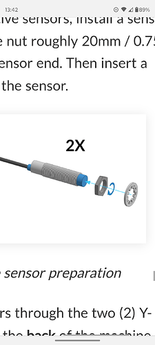

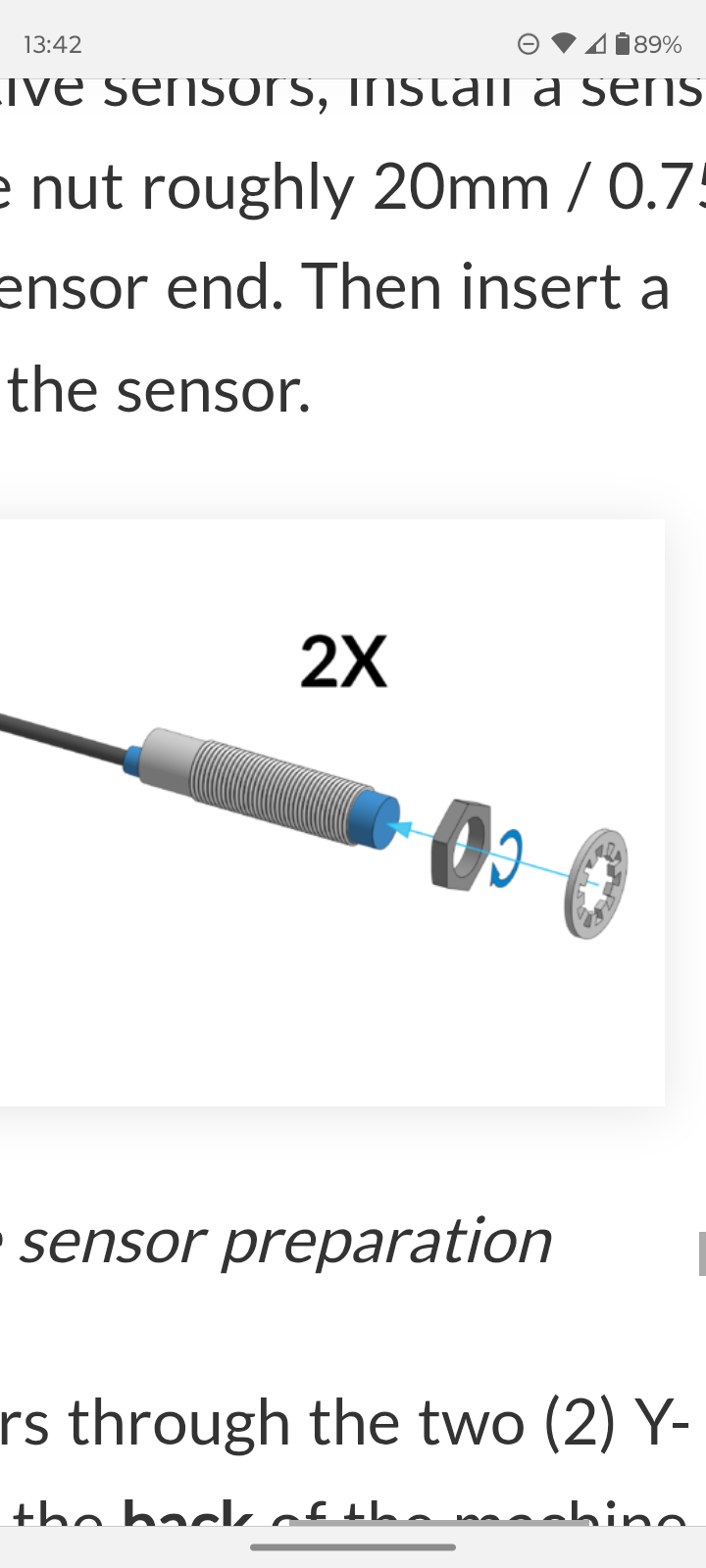

Thanks for the help, we are just getting around to it. Put the metal object text to what? And where is the sensor light?
@SamanthaW A metal object close to the blue cap of the sensor. The LED is at the back of each sensor. It’s tiny.
@SamanthaW I forgot to add in my very first reply that the Y2 sensor (the one on the right) will not generate an alarm. But the LED should still light up.

We are getting the alarms. I guess I’m confused when you said the blue cap are you talking about the actual cap of the router?
@SamanthaW the blue cap on the limit sensors
@SamanthaW I guess the first question I should have asked is if you have an Altmill, Longmill, or other CNC. I don’t think the Longmill comes with limit sensors unless you purchased the upgrade.
we have the long mill 2.5, we just found the sensor that wasn’t installed because our model didn’t require that. We have the auto 0 touch plate
@SamanthaW Without the sensors, I probably can’t provide much help. I have the Altmill and don’t know how a sensorless Longmill behaves. I think you need to disable the limits in gSemder since they are of no use. If you install the sensor, then I can help further.
