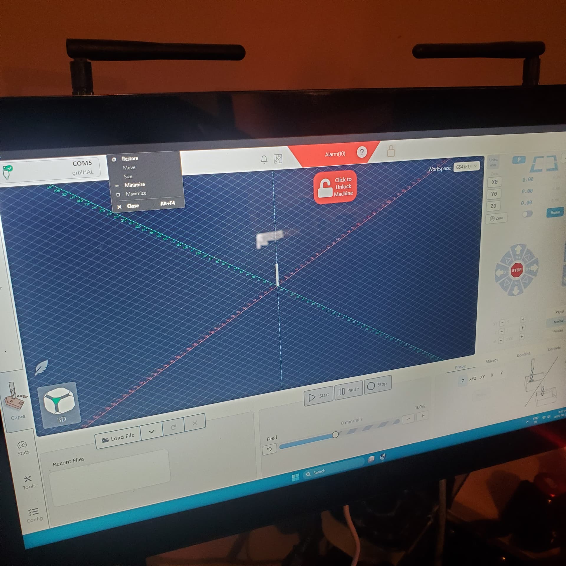

I can’t get gsender to clear the Alarm (10). When I click the ‘click to unlock the machine’ button the big Red machine status LED switches to blue for a fraction of a second.

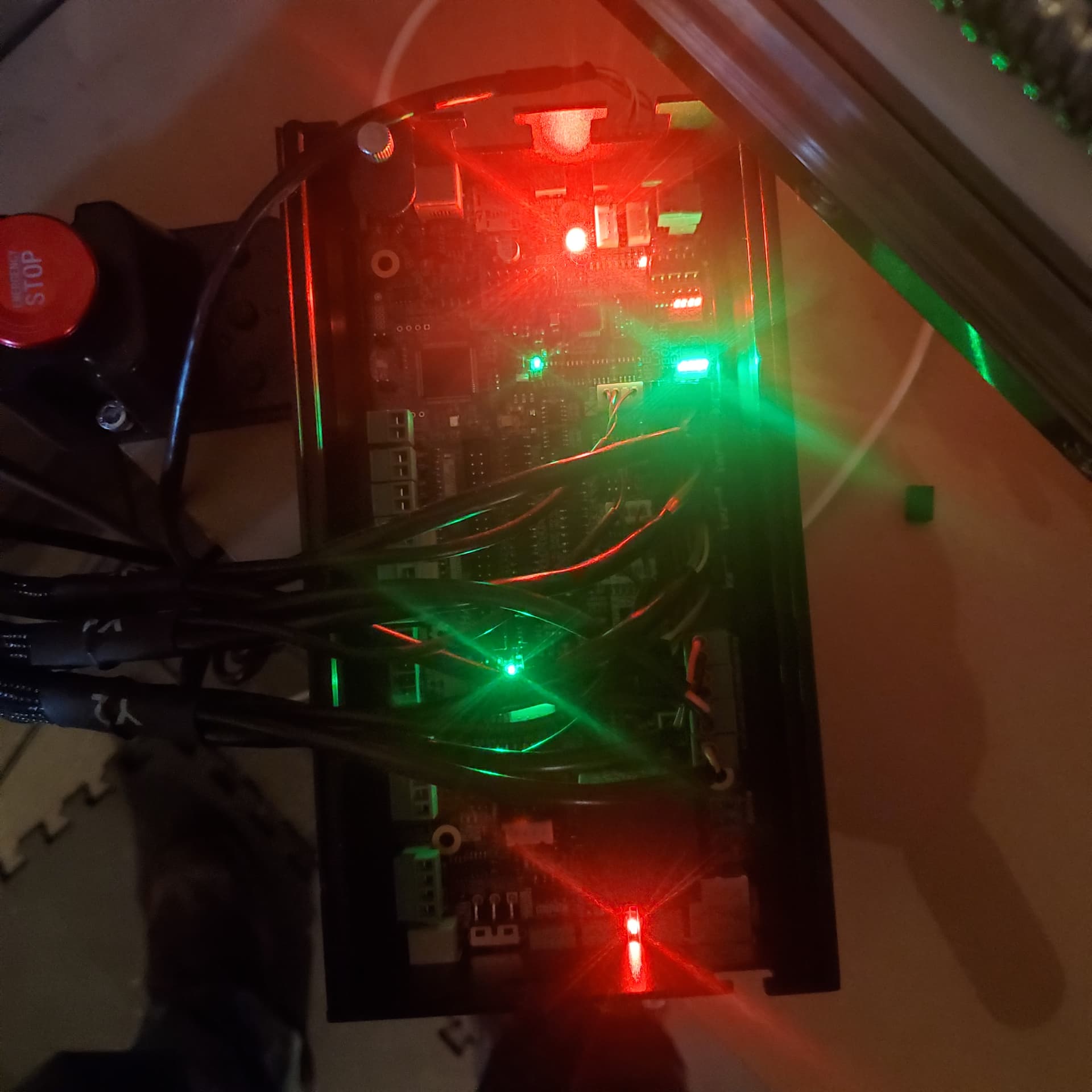

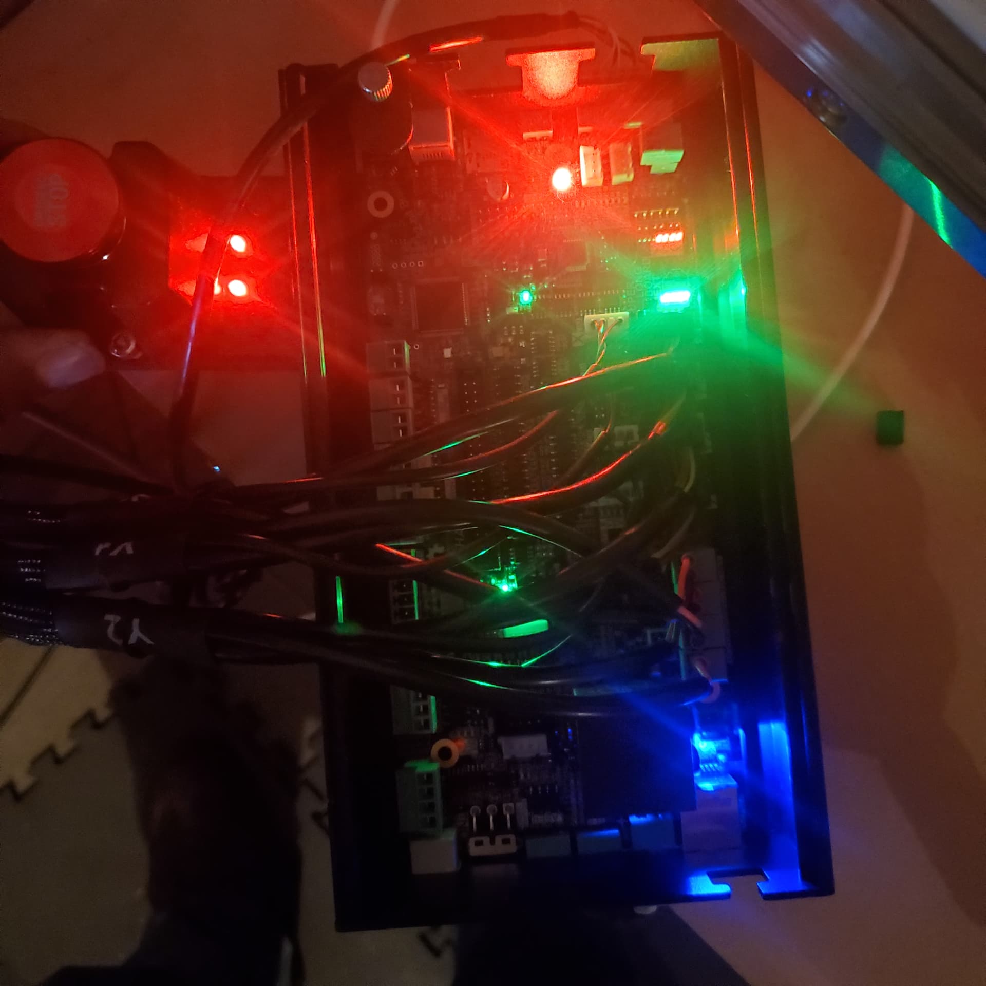

I have cycled the estop to check its function. In the run position( up) the red LEDs on the estop light and I see the ‘halt’ LED goes out on the SLB. Then I need to cycle the estop switch to make the ‘halt’ light go out again.
If I unplug the switch from the SLB. That halt light goes back on. I take this to mean the estop is connecting the first two wires the way its supposed to.
The programable buttons also light the LED like they are supposed to.
Another thing of note on the back of the board near the power switch I can’t find two pins to bypass the estop. Also my board had a large relay in that area that I don’t see on the diagrams. As I operate the estop that relay activates.

I can’t clear the error in gsender. When I press the software clear button. The SLB board status LED flashes blue for a fraction of a second. Then back to Red.

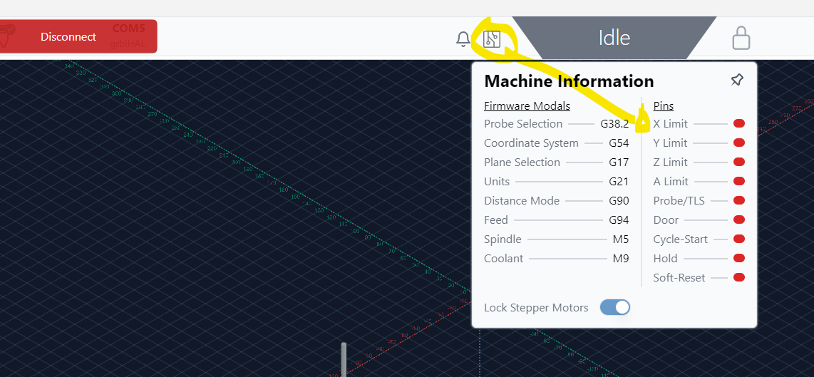

In the good ol’ days, we had a pin list in gsender - tab calibrate - where one could see if an input was triggered. Since I have never updated beyond 1.2.2, I am not sure where in the newer versions of gsender you can find this feature now. I however cannot imagine it has not been removed. It is a powerfull aid when trouble shooting.
Here’s how it looks in 1.2.2.

@Spamming_Eddie We still do (: Button just to left of the Machine Status
Ah thanks Peter, I’ll bookmark your picture for future refferencing. My gsender is outdated but has all the capability I need. It has its drawbacks when trying to help out on this forum though. Thanks to you I now can stea.. borrow yours.

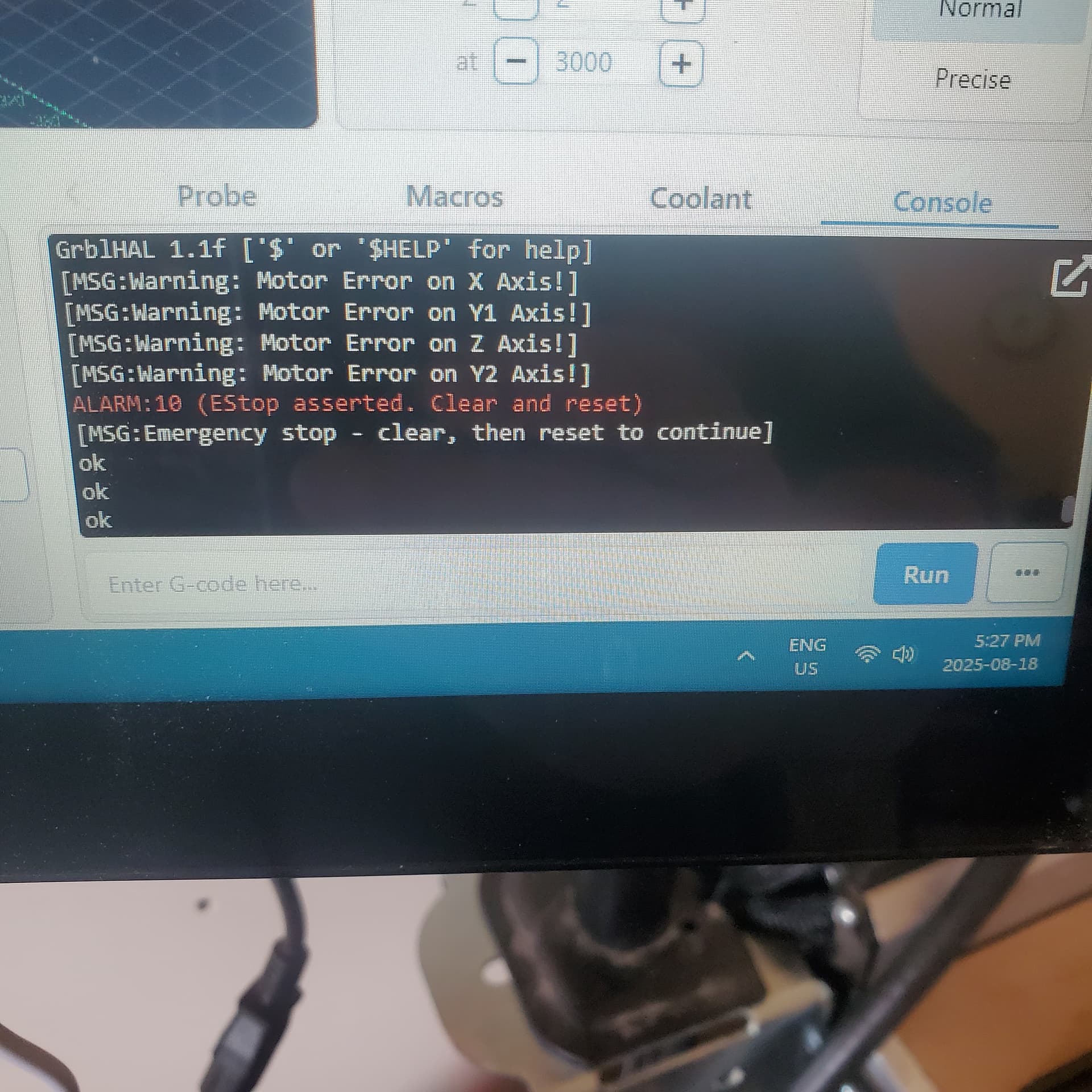

I received a new SLB ext and e-stop switch today. Unfortunately, the identical problem persists. Assuming the new board and estop are good. I looked at the limit switches again. They are all indicating not tripped. Then they show red LEDs when I put my screwdriver in front.
Also, all of the steppers are energized. I can’t push them around.
Is the below picture what you would expect for a machine in e-stop?
