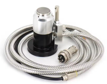

I’m running into what I think is the same issue as Sparky1 much higher in the thread.
My Altmill tool setter is at the machine home (X0, Y0) in the back left corner, and is one of the abundant Aliexpress ones that stands 67mm tall.
When I set my workpiece 0 and start the job, the initial tool probe wizard fires up and takes the machine back to above the setter, it rapids down to the seek position, and then throws Alarm 2 before probing.
I’m wondering if this is because the workpiece Z top is higher than the tool setter?
The code in the terminal shows all the positioning being machine coordinate (G53), but then the probing distance for Z is -122 which is a lot farther than the ā€˜max probing distance’ (I have default set):

G38.2 Z-122 F150
ALARM:2 (Soft limit alarm. G-code motion target exceeds machine travel. Machine position retained. Alarm may be safely unlocked.)
[MSG:Reset to continue]
I’m not sure how the Z-122 is calculated.
I tried to debug this a little further by myself, and am even more confused :laughing: As far as I can tell, the probing distance is being computed here: gsender/src/app/src/wizards/automaticToolchange.tsx at master Ā· Sienci-Labs/gsender Ā· GitHub
This sounds like it should cap the input parameter at the maximum possible, but I don’t even see the input parameter being used in the method. It looks to always return the max (machine travel - workspace tool change position [the z of the toolsetter in settings?] - 2). The ā€˜30mm’ of probe distance doesn’t seem to come into play in this method or where the value of it is consumed and put into the gcode.
