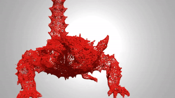

I don’t know how gSender goes about creating an outline but I’d be interested the broad strokes. I was thinking of how I’d TRY to do it. This is how I’d approach it.
What about constructing a 2D point cloud from the G-code and then creating a convex hull from the point cloud. That gives you a shape to start with and then there are algorithms to ā€˜shrink wrap’ the shape onto the point cloud. I don’t know how long it takes for something like that to run but it’s just what popped into my head for a possible way to make a decent outline.
Doing a quick search I found point2mesh on GitHub. In this gif you can see the convex hull on the right and then its used to wrap the points of the lizard to recreate the mesh. I assume it would be faster if you only need 2D.
lizard2
I think it’s interesting if you look at the whole pipeline for CNC it seems like the outline would be easier to do with the information that the CAD program had. It had all the geometry and reduced it to G-code and now it seems like you need to recreate some it in gSender to do things beyond just sending G-code.
