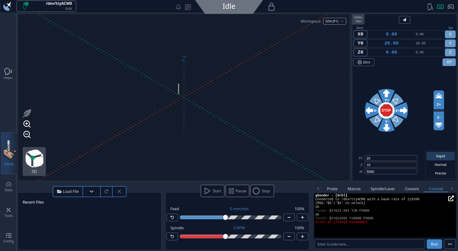

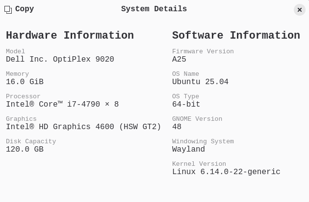

So far version 1.5 is all kinds of broken for me. Here’s some system info. I also tried an X11 session and everything was the same.

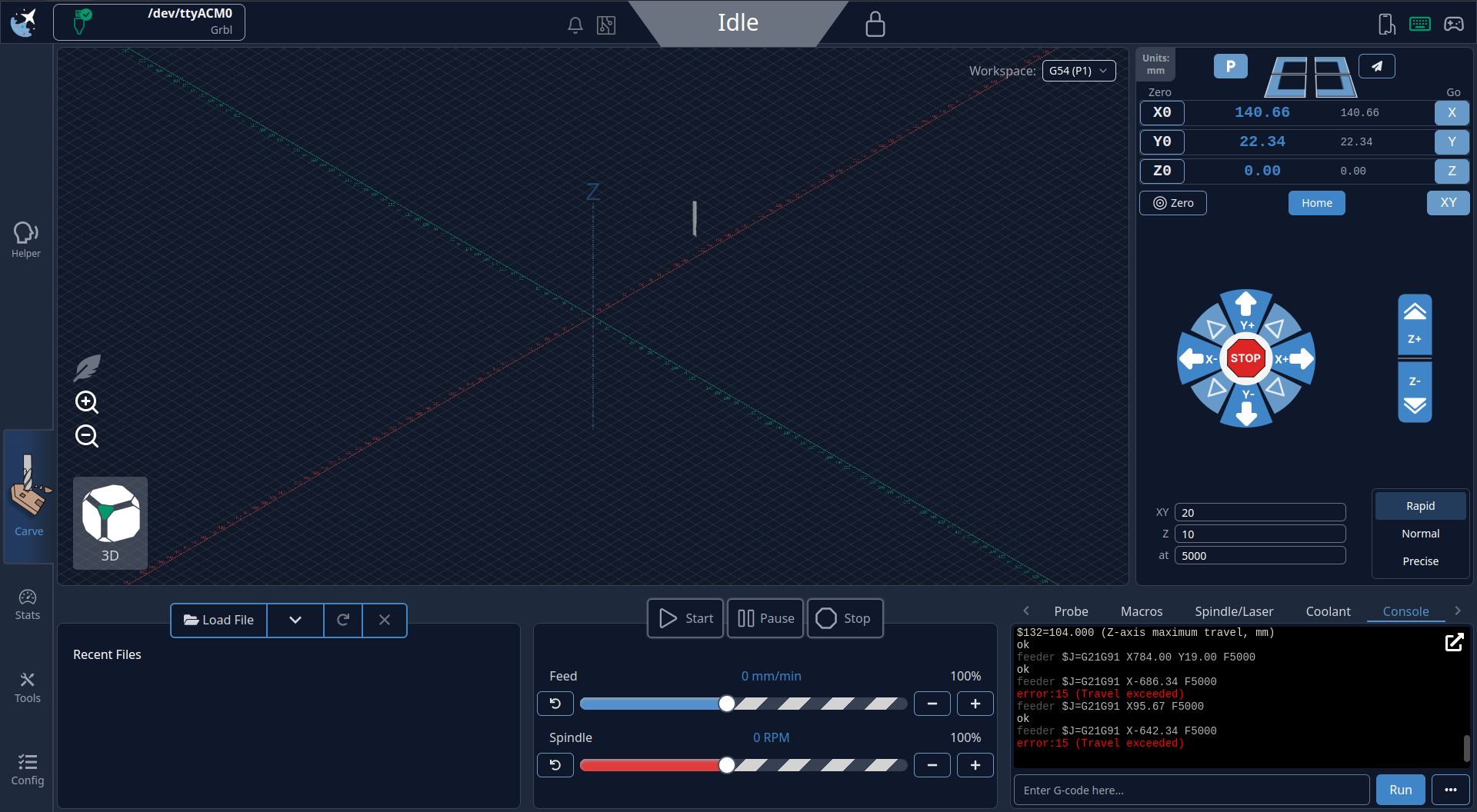

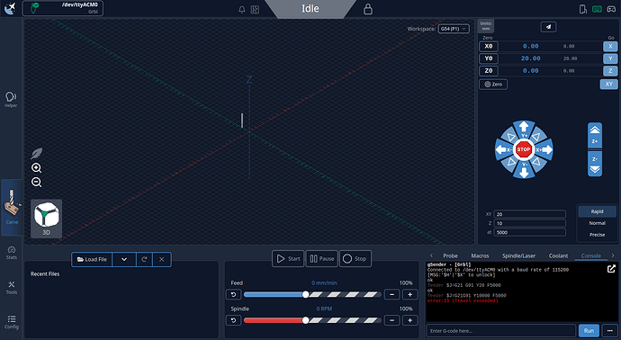

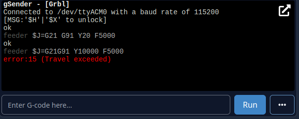

My first problem was jogging. Continuous jogging doesn’t work most of the time. Here I connected, homed and did a single click jog without issue. Then it failed on the first continuous jog attempt. Y10,000 seems way too big but I don’t often look at the output from jogging so what do I know.

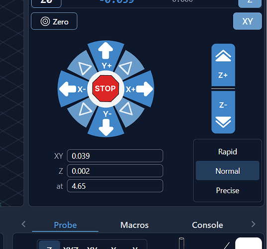

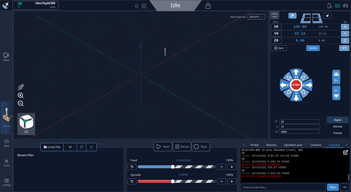

Then I noticed that parts of the UI are missing!
Where are the corner and park buttons? They were there yesterday!

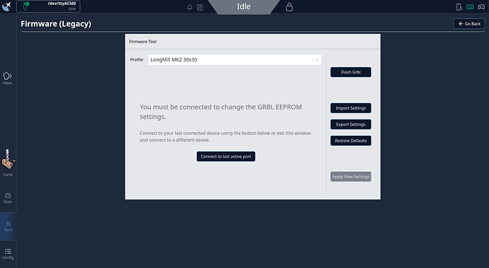

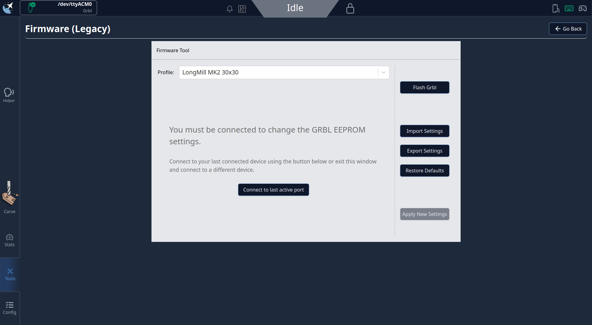

Maybe it’s some problem with my firmware settings, let’s check.
Apparently I’ve been jogging around without connecting!?! Let’s connect inside my connection, that should bring us to a Level 2 connection. Or maybe it’ll be a squared connection?
Hey I found the missing UI elements! Too bad I still can’t jog right. The corner buttons also give me a soft limit error now that I have one to click.
This was all done with the Debian package. The AppImage wont even run. Can’t find libfuse.so.2. I guess that’s because Ubuntu is on libfuse3? I was able to extract the image and change owner and permissions of chrome-sandbox. After that it ran! With all the same issues as the Debian package unfortunately.
I ran gSender from the terminal so I have the output from a short Wayland and X11 session.

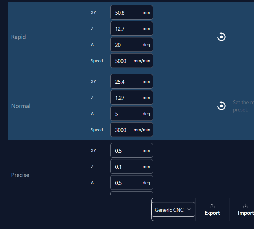

i recently found a fix for continuous jogging that for me was only bugging in rapid.
instead of having 20 for the XY change it to 5, sure you can only move 5 at a time when tapping , but it is a ā€œfixā€

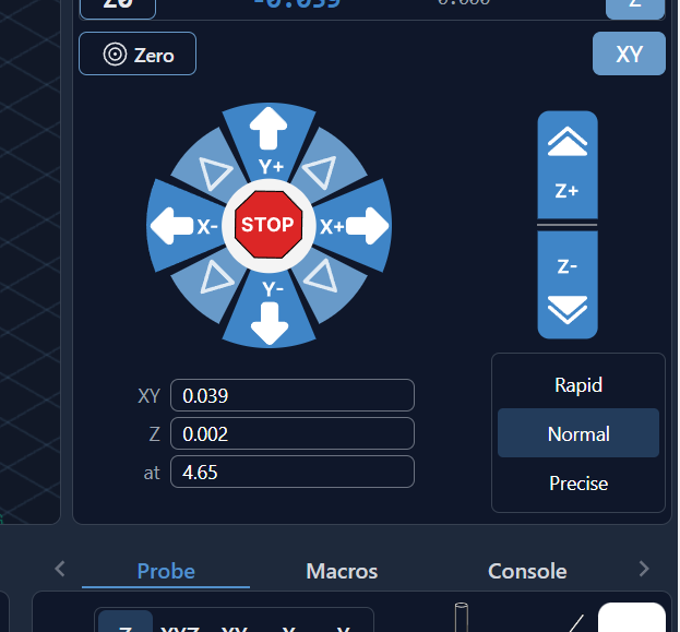

I just installed gSender 1.5. I’m have all kind of problems also.
Problem: after one day I cannot jog in ā€œNormalā€ speed. First day jogging was OK.
When you try to jog, the console gives Error 22: undefined speed rate.
Under Configuration the Normal jogging rate somehow got set to 0 but changing it to anything does not fix the problem.

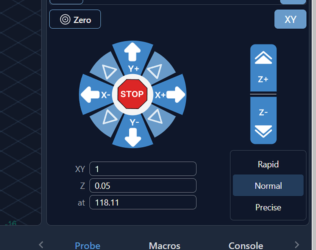

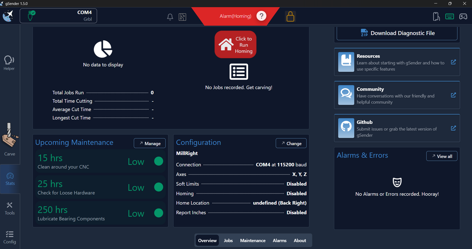

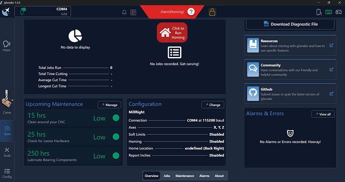

I’m also having a problem with gSender 1.5.0 and jogging. I have an ACER Aspire 5 laptop running windows 11 connected to a 1st gen MillRight CNC. In the past (only a month ago) I was running V1.2.2 with no problems at all. I had not upgraded because I am always wary of Beta versions of anything. When I saw that 1.5.0 was on general release to the community I decided to upgrade my system. I have 2, thankfully I only upgraded my smaller older system! Anyway, I followed the install instructions rigorously and appeared to have no issues. However, I wasn’t able to jog anywhere even though I had set the machine to MillRight in the software. When I looked at the jogging settings I realized that they were nonsense. So I reset the values to those that i knew had worked previously. Eureka! Simple fix, happy user. Not for long! If I pressed the diagonal jog button the system froze. Similarly, if I tried to press a single jog movement it may jog 3 ot 4 times and then freeze. Trying a continuous jog was useless. To reset the system I have to power down the controller and reboot gSender, but then I noticed another problem. Even though I had updated the correct jogging parameters in the config icon and the correct XY, Z, and ā€œatā€ numbers were displayed in the ā€œNormalā€ jogging window when I rebooted, as soon as i toggled between ā€œnormalā€ to ā€œrapidā€ and back to ā€œnormalā€ the jog settings went back to the gibberish numbers that were there before I updated the config settings. I have attached png files showing the two ā€œnormalā€ setting. I’m old school and still work in inches the correct settings as XY 1, Z 0.05, at 118.11. The ā€œatā€ may seem odd but its what came back when i entered 3000 mm/min as the speed in the config menu. So it seems that the firmware is not updating correctly, and this may be causing some people like me problems.

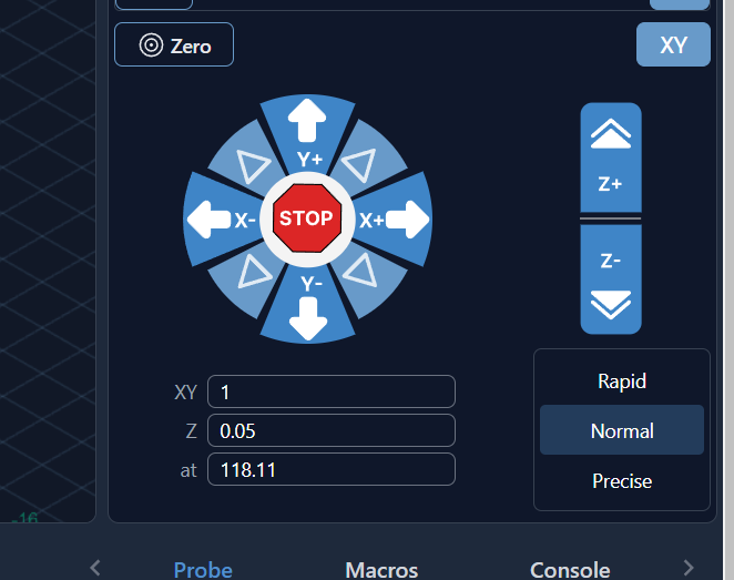

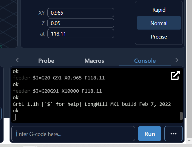

Because of this I decided to look at the consul readout after rebooting the system and before I tested the jogging again. Here I noticed another problem, in that there was a disconnect between what was reported as the machine settings in the Stats window, and the grbl commands in the console. In the config I had set soft limit, hard limits, and homing, to off but the lines corresponding to soft and hard limits in the gcode console were reporting as ā€œonā€. I manually changed the gcode in the console and that has solved that problem for anyone who may be having ā€œlimitā€ problems. I thought I would give the jogging test one last try before I gave up and tried to contact gSender support. I first made sure that all of the settings were correct in both the config and firmware sections and were showing up correctly in the jog window. As before the system allowed me to jog a few times either left or right up or down and then would randomly. I tried this a few times to see if there was a pattern and there wasn’t, but what I did realize was that, as Michael saw in his console readout, when the jog button worked the readout would be something like $J=G20 G91 X0.965, F118.11 in my case, and this format would be consistent while the jog worked. However, as soon as it failed the gcode was corrupted it now read $J=G20G91 X1000 F118.1. The first two G commands had been combined and the X distance command had increased from ~1 to 10000, which is the same increment that Michael saw even though he was using a different computer, different OS, different CNC with different connections, and trying to jog in a different direction and with different starting increments. To me this seems like it has to be a bug in the software

which, for whatever reason, is defaulting to the largest X or Y increment available. This may be because the two G commands at the beginning have been merged but I’m not a coder. I’m attaching my diagnostic file, gSender file, and format files together with some screenshots to illustrate the problem. I hope this helps someone get to the bottom of this
