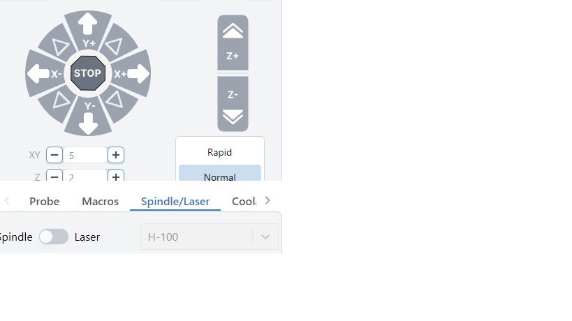

The bottom 1/4” on the carve tab and the bottom inch and a half on the stats tab are cut off and require vertical scrolling up and down to see..
Given the touch screen and lack of a mouse to do this scrolling, this is a major pain
  • the vert scroll bar isn’t finger friendly
  • Pressing in the window and sliding up and down has a good chance or hitting some othercontrol
  • And because the run
 plus and minus buttons are also covered up by the windows task bar that likes to pop up when a finger is in that area

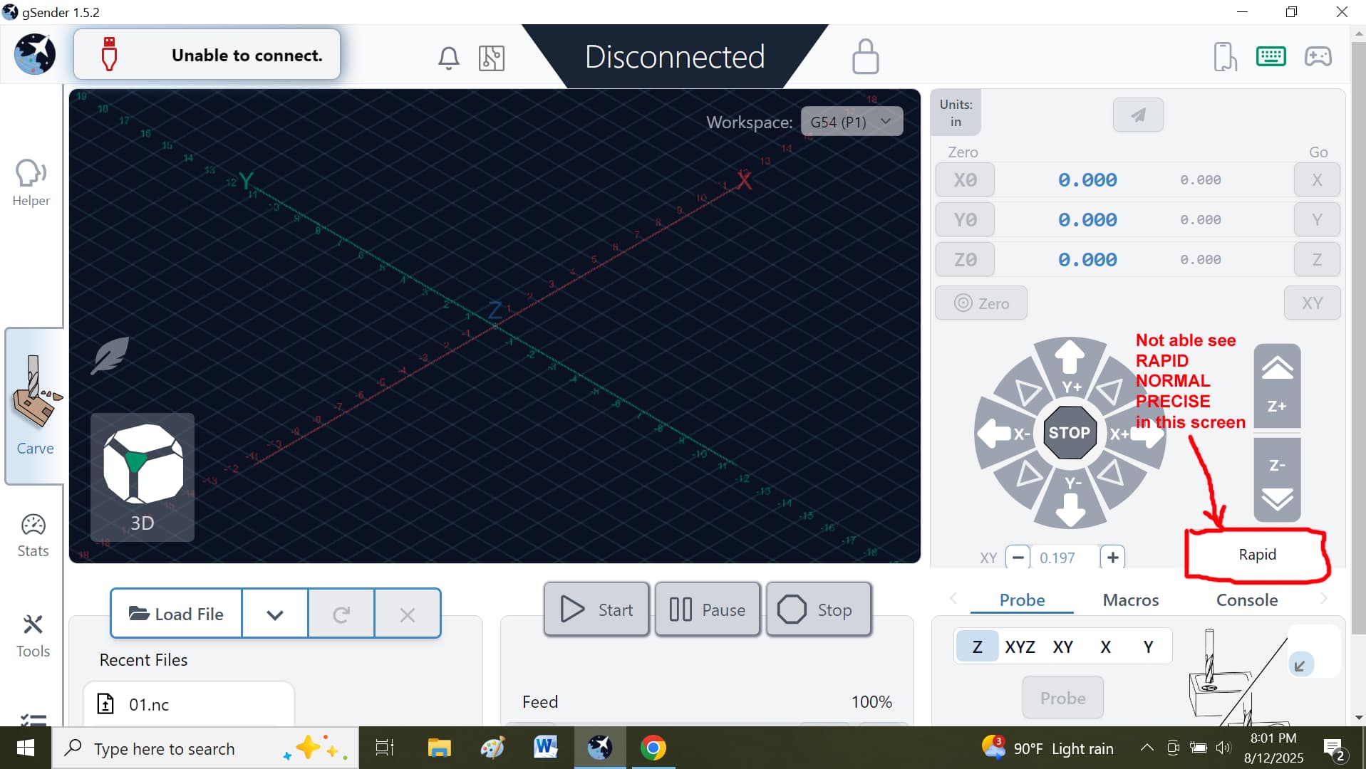

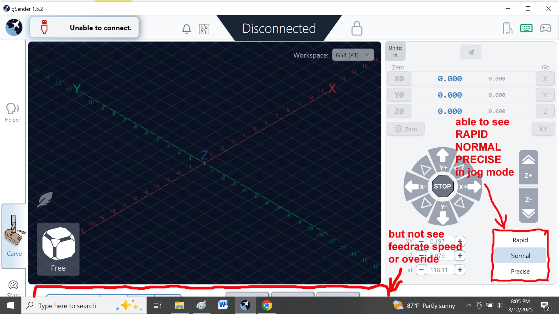

I am having a problem with the g-Sender display screen on my computer. When I have g-Sender in maximize the screen display cuts off the feedrate, feedrate override, start, pause, and stop buttons. But it displays all three buttons for jogging, (RAPID, NORMAL, and PRECISE).
        When I use the down size screen display, it shows the feedrate, feedrate override, start, pause, and stop buttons, but it cuts off two of the three buttons for jogging, (RAPID, NORMAL, and PRECISE).
        Is the solution or fix for this? Please see attached photos.
@dhook You may want to look at the resolution settings for your monitor.
My computer display is set at 1920 X 1080, which is the highest setting and also the recommended setting.
