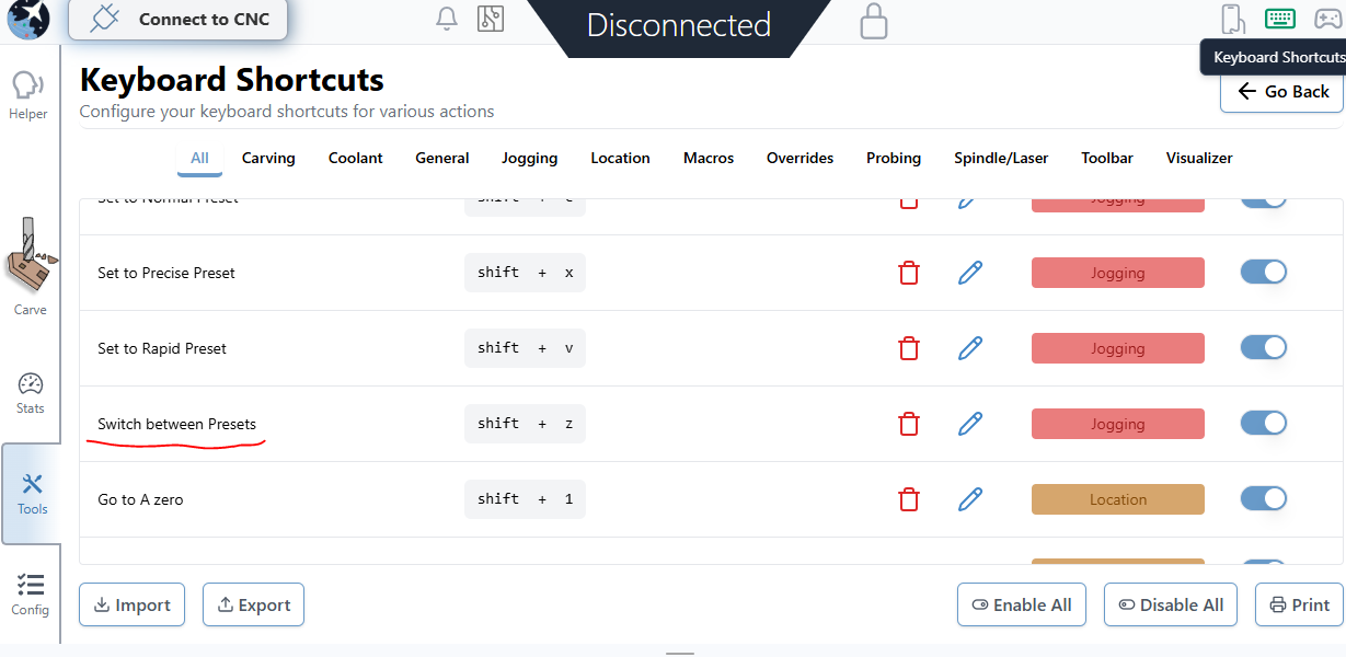

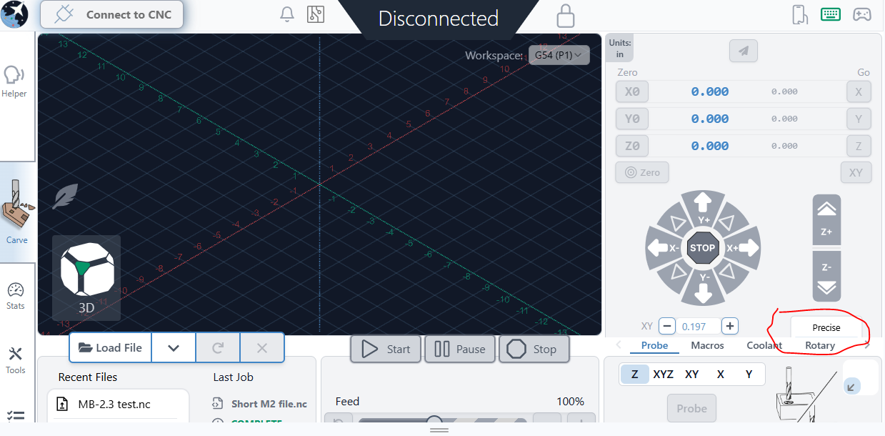

When I start up GSender, the jog defaults to precise. When I left or right click on the “Precise” button it goes blue but I can’t see or scroll to Normal or Rapid. . Any ideas please?
GSender -1.5.7 - previous version worked fine.
Machine in Australian BlueCarve Bluey V1 Running and an Arduino CNC Shield) Preety much an X-Carve.. Thanks.
@Konkon What version of gSender are you running? What machine do you have, and if it is a Sienci machine, what controller are you using? This information may help tech support to resolve your issue.
Good Questions thank you. GSender -1.5.7 - previous version worked fine.

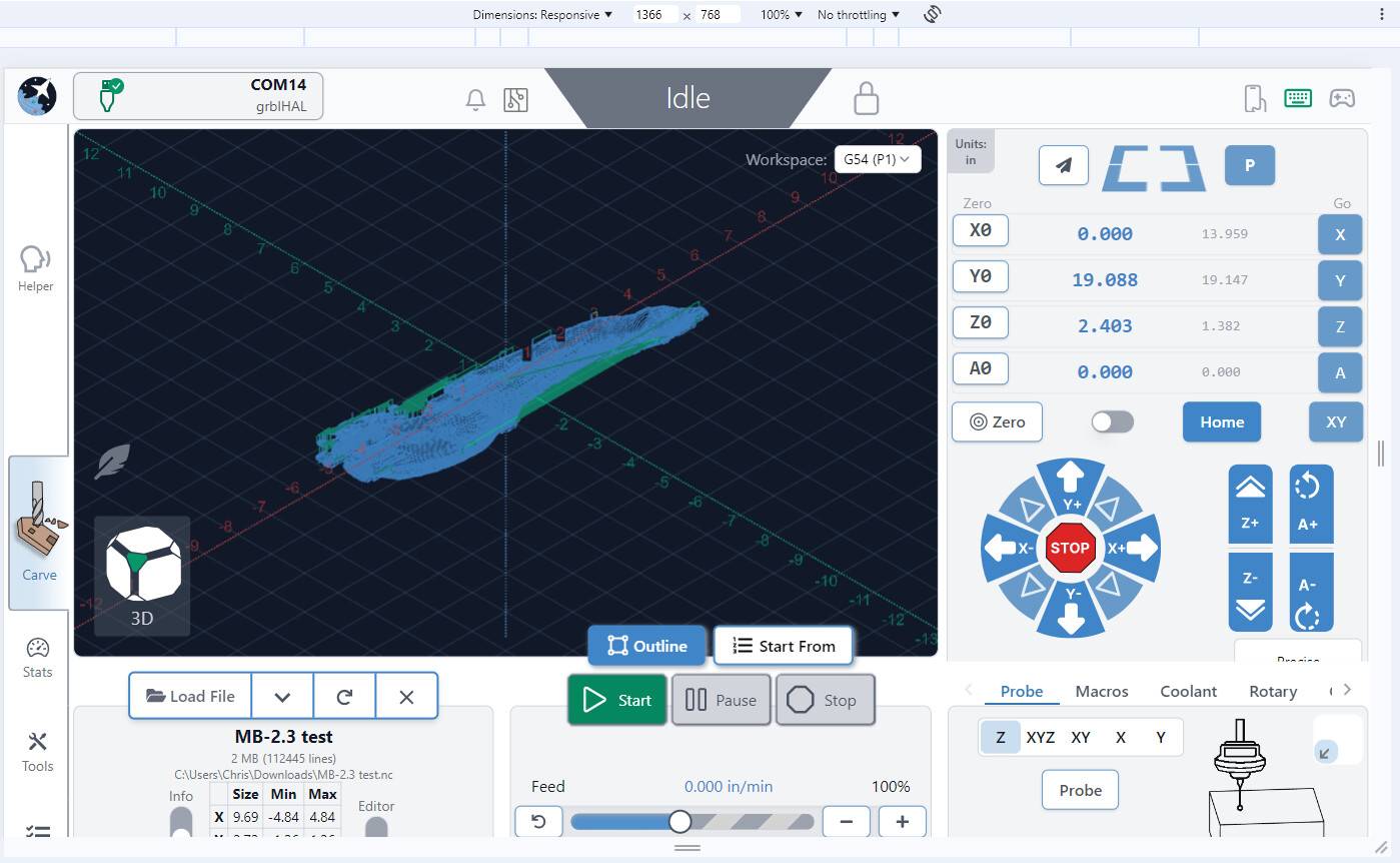

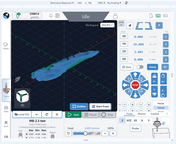

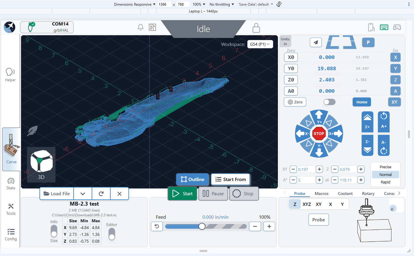

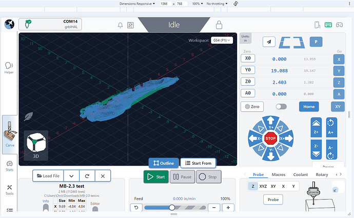

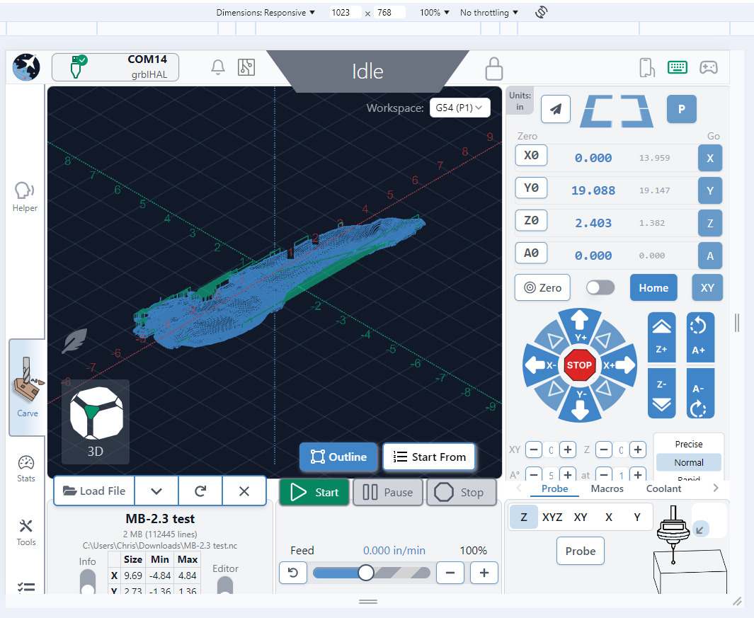

To anyone on this thread with the resolution problem that would like to try out the work I spent on it today and let me know if it seems to fix things and look good on your end, here’s an experimental Edge download you can try out over the weekend
There’s still a couple remaining tweaks, but if overall it seems to fix everyones setups then the feedback will be great to hear and we’ll be able to push the changes for the next Edge build!

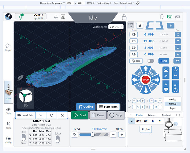

It’s seeming like with the tweaks made the UI looks nice and normal now on 1366x768 and even 1024x768
