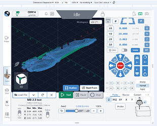

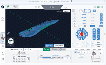

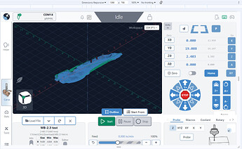

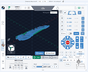

Below are screenshots I took once I was nearly done making all the changes, showing the before and after:
Smallest screen size
Commonly mentioned 1366x768
