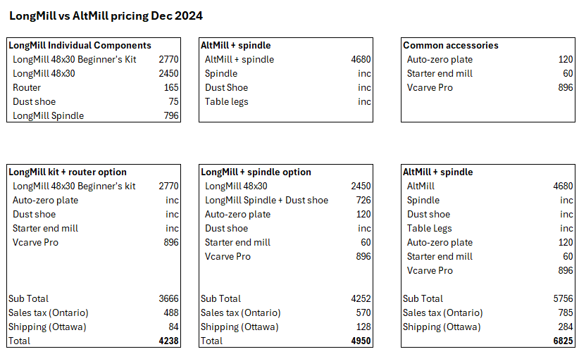

Any reason you are not considering the Altmill? Once you factor in the add-ons, the price difference becomes less important.

Before I changed my mind for the Altmill, I had done a price comparison. A lot of the add-ons you will need are the same for both the Longmill and the Altmill. This includes software, tools, dust extraction, computer, etc. As I stated in my previous post, the more add-ons you add, the less the important the price difference between the Longmill and Altmill becomes.

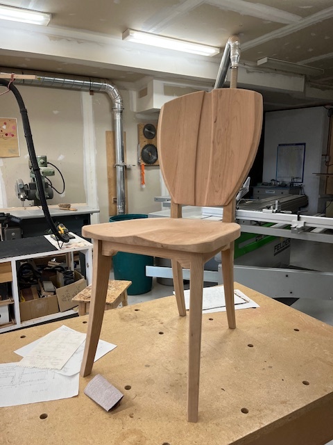

I used to own a Longmill MK 1 (31" X 31") spoilboard size and made chairs on it (see attached photo). That job required me to lay the rear legs diagonally. It worked. I guess the adage ā€œwhere there’s a will, there’s a wayā€ applied in this case.
(I’d entered a rather lengthy post cautioning you against making a tabletop light enough to move up and down stairways, but after reading your second post where you explained that it was only to do so if you sell your current home, I deleted it)
