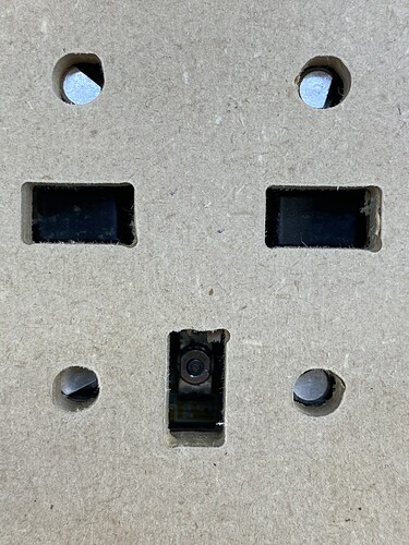

  2. This one is minor and more for me to understand why. So same set up as above. On the rectangular voids (they are all 15mm by 5mm by 4mm deep) I’m getting a perfect cut except one corner has a round cut that extends outside the rectangle by about 25% the milling bit diameter. So imagine a rectangle with the top left corner having a small circle extending outside the rectangle. It looks to me like it’s where the bit enters/exits the initial cut so I think I have something setup wrong in kiri:modo. IIs this caused by a climbing/non-climbing cut? Thoughts?

The other error I’m going to add a picture. I think I have a setting wrong.

re: your picture. What is your plunge rate and depth?
I always move the nc file onto the laptop. Stepover is .5 (50%) and step down is 2mm. overall depth of piece is 6mm (well nominal 1/4" hardboard). Z zero is set at about 0.5mm above stock. I was thinking climb cuts etc. The Makita turns clockwise (looking from the top down) and the cuts are all clockwise. I should say that this image is X plane top to bottom, Y plane left to right, sorry. When i watch closely i can see that on each concentric cut, each time the cut moves into the next inner cut (that would be also on those rounded out corners) it slightly moves out. Everything is tight, there is no play in any axis and $1 = 255. You can see that the round cuts also have an entrance mark. However it’s fair to say that the round holes are only 7mm diameter, with a 2mm diameter bit, so maybe i am expecting too much. Also, honestly it’s probably faster and easier to have the cnc mark the round holes but use the drill press to cut them.

@tuejan I don’t think that you are asking too much at all. I had a similar problem when cutting out box lids. I could always see when the next step down occurred. Two things fixed it. Now, I am using VCarvePro, so you may need to look at different options. First, ramp in your cuts. That will remove any one spot where your bit is plunging straight down. Second, is to do a final pass at full depth. I don’t know how Kiri does this, if it does. In VCP, I can tell it to leave .001" for example for a final cut. So, to use your pics, I ramp into the cut for the rectangle, but the outside dimension of the rectangle is .001" too small. Then, when the full depth has been reached, a final cut is done, but at full depth… Since the cut is only .001", the bit can handle full depth, and it removes any “steps” that show in the other cuts.

Thanks for all the info folks, new to this but trying to ramp up quickly. So I spent a few days just learning Fusion 360 and cncjs. I’ve gotten rid of the weird skipping, I think it was screen off power function. I’ve also got rid of 90% of the weird corner issues where the bit seems to go to far into the corner. This “fixed” when I moved from Kiri:Modo to Fusion 360.
So the rectangular pockets are now totally fine. The circular pockets (again I realise I should be using a drill for this part) are still not great. They are eccentric, around a 0.4mm difference. The longest the “circle” diameter is, is always on the -X-Y to +X+Y or diagonally. Which made me think that maybe the X and Y motors are not responding the same exactly. So i checked the firmware gcode and everything is exactly the same for X and Y. So I checked the tightness of the V wheels ( this is a MillOne) and they are all tight. I checked the couplers, tight. I looked at the squareness of the X axis to the Y axis (but I’m not sure exactly how to check this so i measure the gap from the side wall of the mill to the Y axis at the front and back most travel of the X axis and it was the same value so I guess it’s perpendicular.

  • Removed makita router, checked diameter, checked diameter of printed holder and noticed it wasn’t quit perfect. Adjusted(filed) the clamp areas on the printed holder so the holder is tighter on the makita. This fixed the weird eccentricity from top left (in image in previous post) to bottom right.

Not really much further forward. I have a slightly better hole that is typically widest on the diagonals , so measuring from -X-Y to +X+Y or -X+Y to +X-Y. So it’s sort of squared slightly. How slightly, widest measurement on a 10mm circular pocket is around 10.03mm to 10.25mm and narrowest (top to bottom or left to right measurement) is around 9.75mm to 9.95mm. I’d like to get the variance to around <0.2mm.
It’s interesting that widest is on the diagonals always. The diagonals are the widest (best) part of the circle as they are around 10.00mm which means the top to bottom and left to right areas are the worst. This would be (think 12o’clock 3, 6, 9) the place were one or the other stepper motor was changing direction. I assume this would be the largest load asked from the power supply (24v 5A, and motors are 1.7A). Wonder is the power supply is not working as intended?

SOLVED!!
So after all the changes I made that for sure made the machine more accurate and made me totally understand the machine and how to dissassemble etc, and get a great view of the different software available, and learn Fusion 360, I finally got a solution.
As I had flats in the circular holes at 4 points on the circle I had guessed it was torque/power related. That being where the system uses the most power as one axis is constantly moving and the other has to change direction (think from 2 to 4 o’clock on the circle) , not the motors, not the stepper drivers, not the cables, not the power supply, not the backlash nuts… it turned out to be the delrin v wheels being too tight.
What i did yesterday was do the opposite of what i had been doing, instead of tightening everything up more and more, I went around the machine and just loosed stuff. Immediately the machine started to make way better circles.
So this is what I had…
And this is what I have now
The outer rect is 70mm and 3mm width cut. These are using a flat end upcut 1.88mm bit. The inner circle wall is 1mm thick. I can still see a flat spot on the right wall of the second smallest circle, and a slight notch in the same place in that inner circle wall.The inner circle is 10mm wide
The measurements are 70.25mm X 70.19mmY and the inner wall is ~1.02mm. The cuts are around 3.15mm wide. The inner circle measured 10.12mm dia So pretty accurate. I found a drill with a 10mm shank and it was a decent fit into the 10 mill hole.
