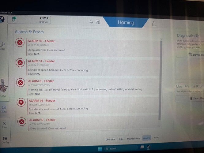

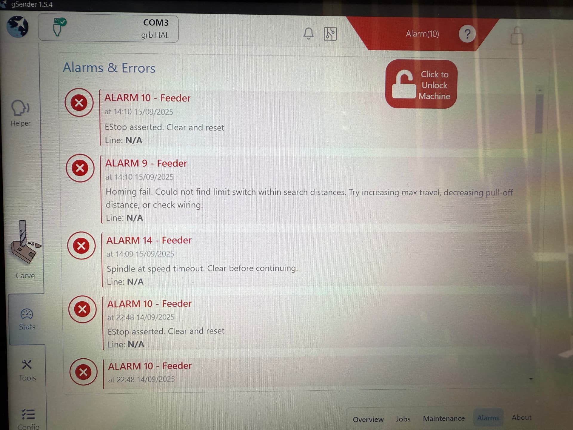

I am able to home my spindle, but once there I am getting (alarms 9, 10, 14).

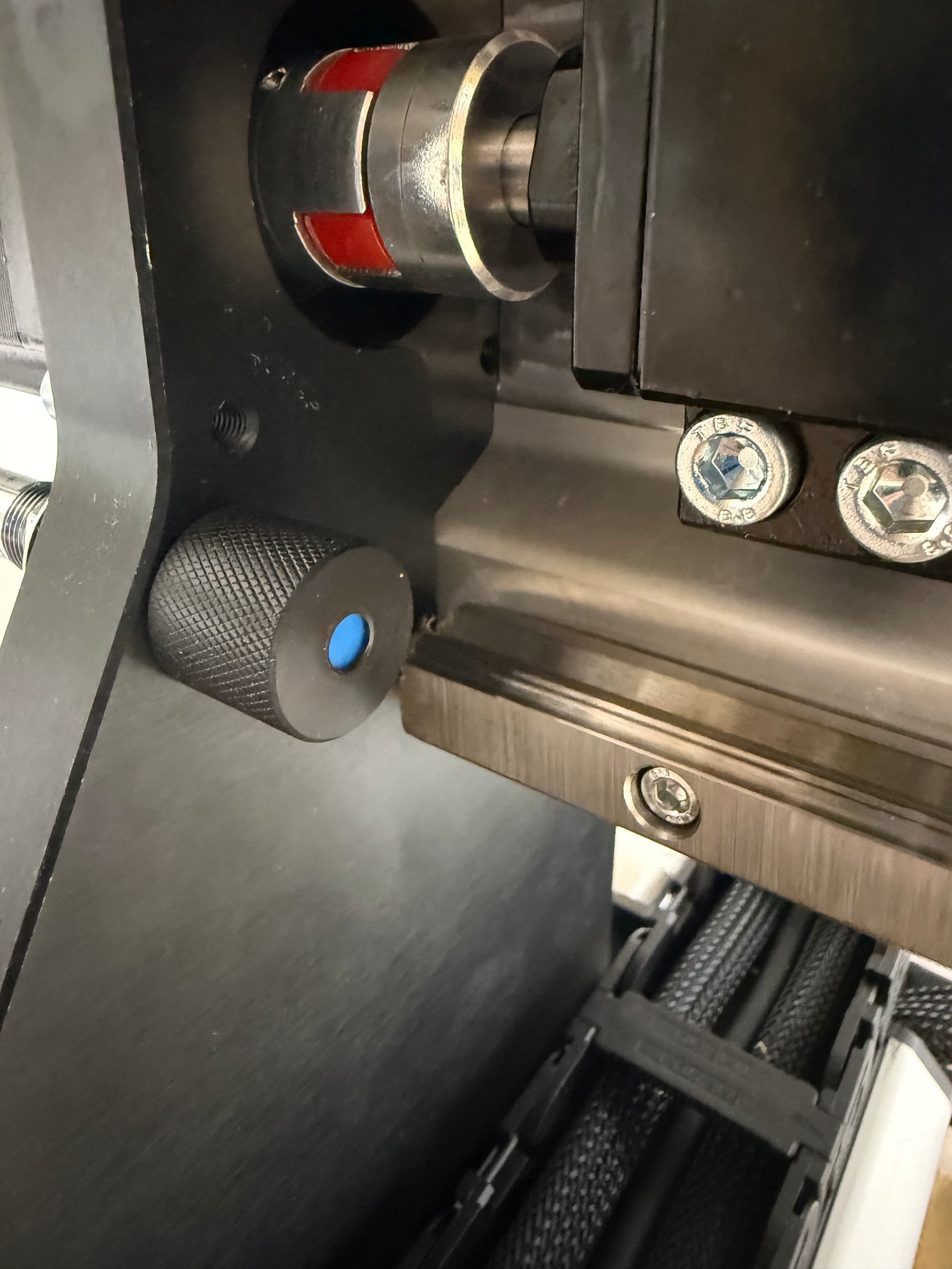

Check the inductive sensors to make sure they are not set too far back (but also not too far forward). You do not want them to get hit by the gantries as they approach.
Also check that they all light up when you approach a metal object. Do them one by one. Each time, the LED at the back of the sensor should light up AND gSender should trip an alarm 14. (I just checked mine and they all do that except the right Y inductive sensor - so I’ll have to check that out. @jens do both your Y1 and Y2 light up and generate error 14 when triggered by a metal object?)).
Also check the wiring for them. When I initially set up the sensors, the LED lit up on one of them but it was still not working. Turns out one of the pins on the Z sensor was bent and not engaging in the connector. Also check the connections on the SLB.

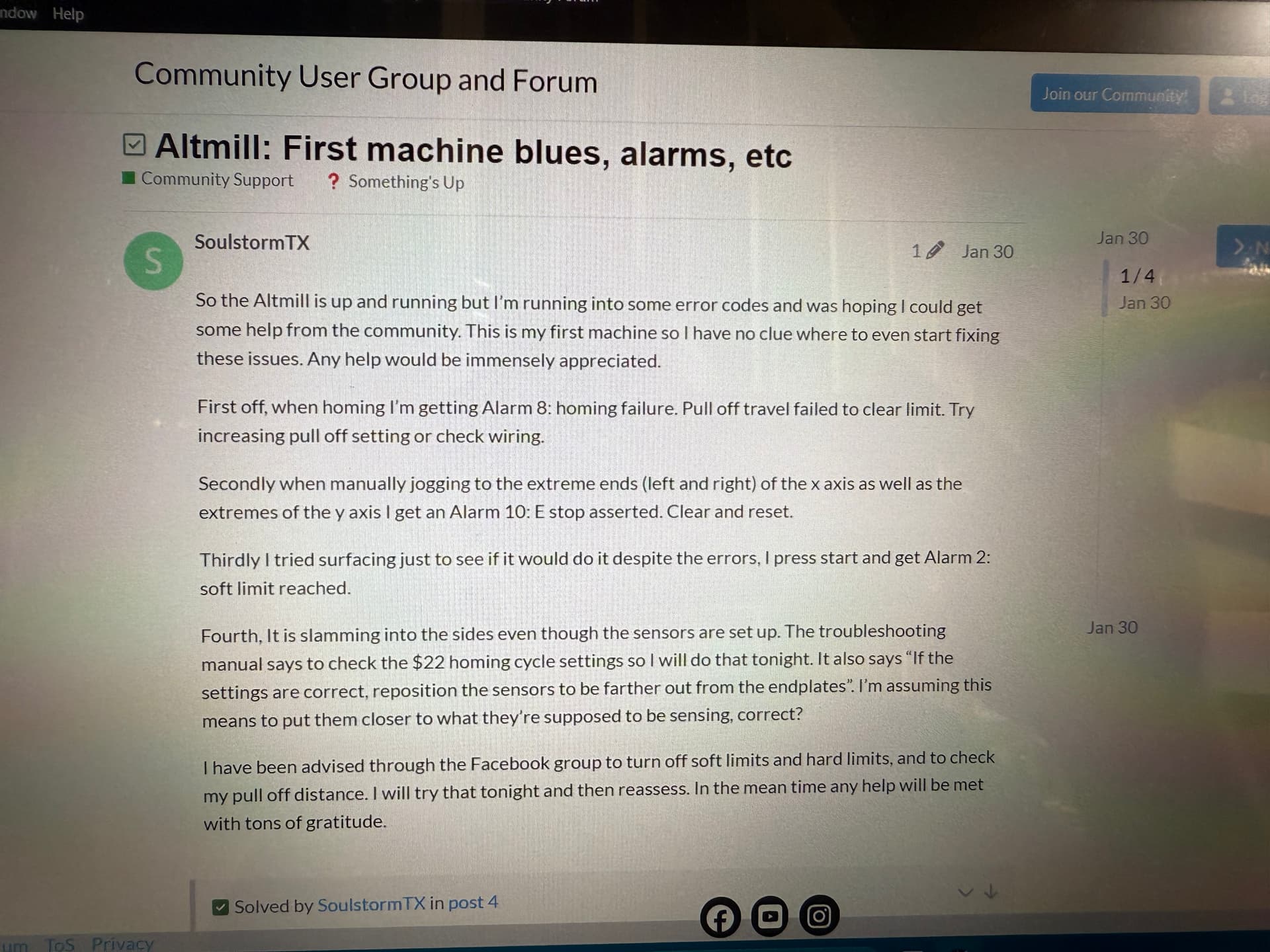

FWIW, another user also had errors and the wiring on the motors was incorrect. edit This is the post I was referring to: E-Stop (Alarm 10) - Community Support / :red_question_mark: Something’s Up - Sienci Community Forum. It doesn’t necessarily describe your issue but it does point out that you can’t rule out manufacturing issues when you troubleshoot.
@Jahuntle Did you look at the troubleshooting steps found here: Homing and Machine Limits - AltMill CNC?
Oh wow, I’ll compare that photo to mine. Thanks for sharing. I have gone through all of the troubleshooting docs I have been able to find.
I think are right correct, it is not completing the homing process. It goes to the right rear and triggers alarm 14. Both y axis sensors are lit up red. I put a metal wrench in front of the x axis and the red light comes on but I’m not getting an alarm.

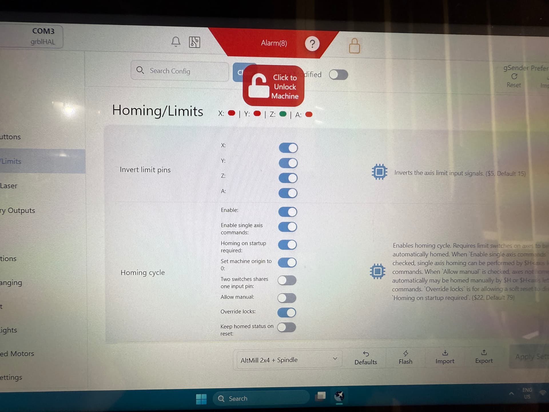

I found that in the other thread, before you started this one. Isn’t the AltMill supposed to Home to the left rear corner? Maybe you misspoke but if the X sensor is on the left side of the machine it should home to the left.
If that is the case, the sensor is on the left but the homing travels to the right, it can be changed in the settings. There are toggle buttons to switch the homing direction of each axis. That could explain ALARM 9 as it’s moving away from the sensor and doesn’t find it before the max travel is exceeded.

Thanks. The sensors now integrated into the bump stop, so I’m at least certain their placement is correct.

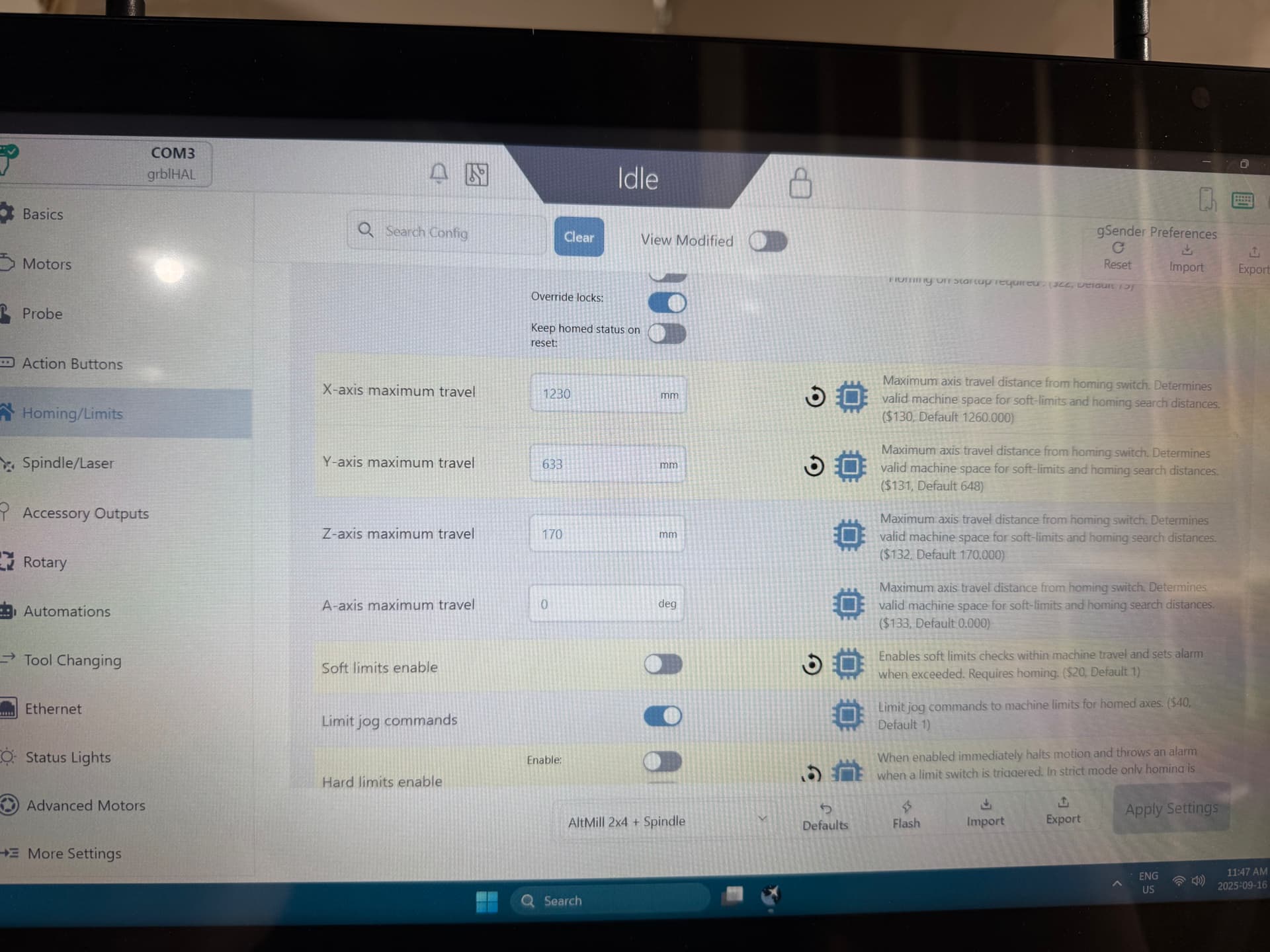

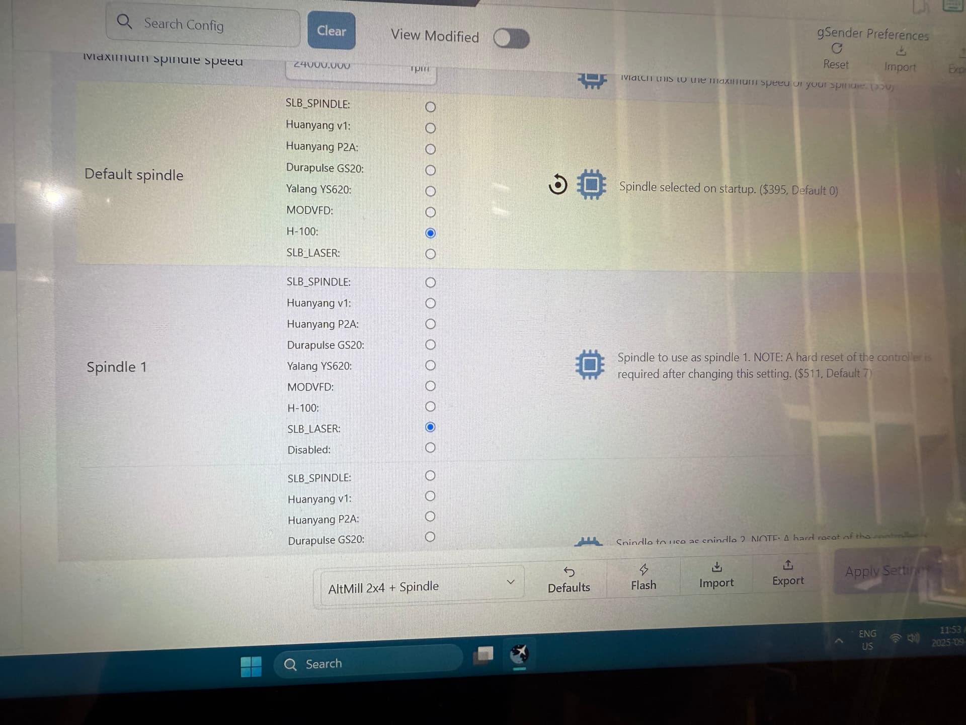

Here are some other settings. The these are either default or in the case of the x and y max travel they are a bit short of the default figures, something that a Facebook group user suggested. Do you see anything there that looks off?
@Jahuntle Dunno. Won’t be back home until late tomorrow.
Thanks. My motors match what is shown in the picture.

Are you saying homing takes the spindle to rear-right? That should not be the case. In the homing section of gSender, what is the setting for “Homing direction invert” for X? It should be enabled to home to the left (negative). Otherwise, it will try to home to the right (positive), but there is no X sensor on the right
Yes, home takes it to the right rear. When it arrives there it bumps the right corner and then alarms (9, 10 and 14) occur.
@Jahuntle See previous post about “Homing Direction invert”. The default is enabled for X but disabled for the others.
