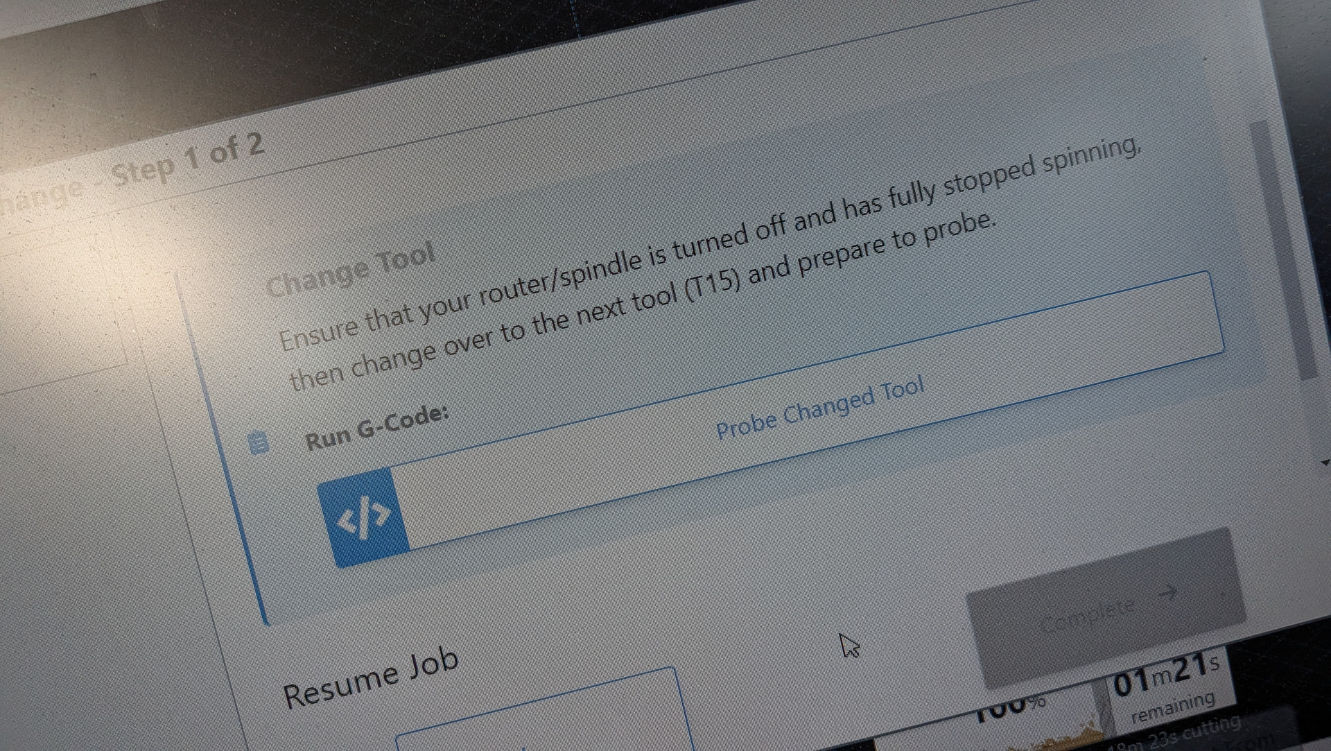

Noticed a bug on tool change prompt

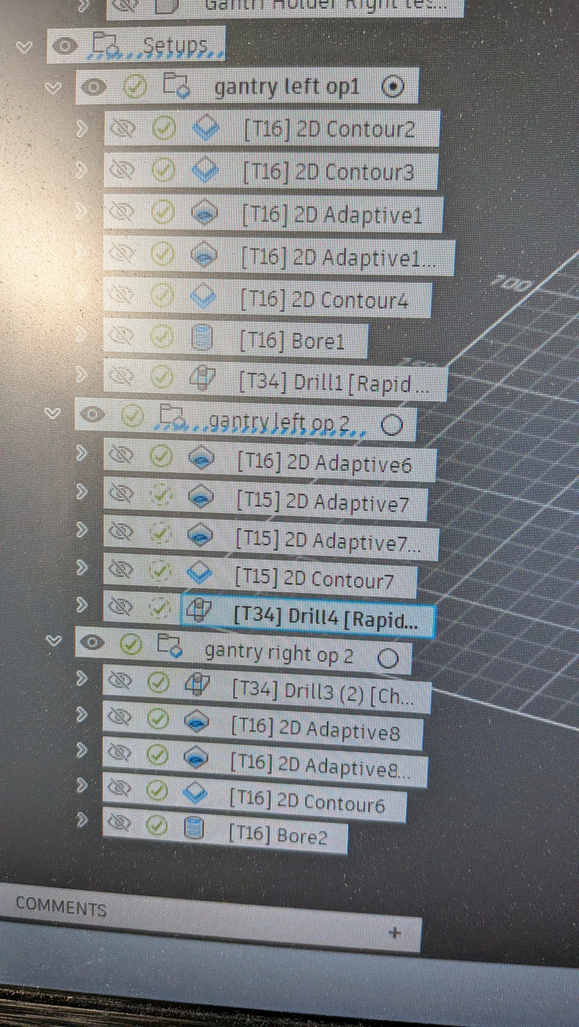

I was murdering some aluminum, and noticed on tool change prompt, it said next tool (T15), but the tool number was the current tool not the next one. Or am i seeing this wrong? It should have been T34 is it not?
The setup i was doing was gantry left op 2

i didn’t look in the console, i will try next time to see what it shows. but it happened again, instead of showing the next tool number, awesome idea btw, it shows the current tool number
i’ve tested today, my first tool was number 21, next tool should be 10, the tool change prompt says i should change over to tool (21) but it should be (10)

note: the .nc file is generated using this plugin i installed in fusion
1 tool change test.nc (2.7 KB)

Looking at your file, I don’t think we’re doing it wrong, I think your postprocessor is.
The g-code standard for M6 commands is that it changes to either the T command on the same line as the M6, or the last T command issued before that M6 if one isn’t on the same line.
See LinuxCNC standard: M-Codes
Your file issues a T21 early, some movement, then a M5 M6 on one line (with no T command) and the a T10 on a following line.
So what you’re seeing makes sense - the first M6 encountered has no T command on the same line, so it prompts you for the last T command sent (T21). The T10 on the line after the M6 is never reached - tool changing doesn’t look ahead, again reference the standard.
You’d need to have a M6 T21 and a M6 T10 (with the T10 on the same line as the M6) if you want the initial prompt for first tool and a second prompt to change to T10.

edit: i asked chatgpt to show me an example based on your comment, it showed me the code down below. if this is what you mean i understand now. that means it’s not a bug, i also suspected the processor, therefore this is solved :sweat_smile:
