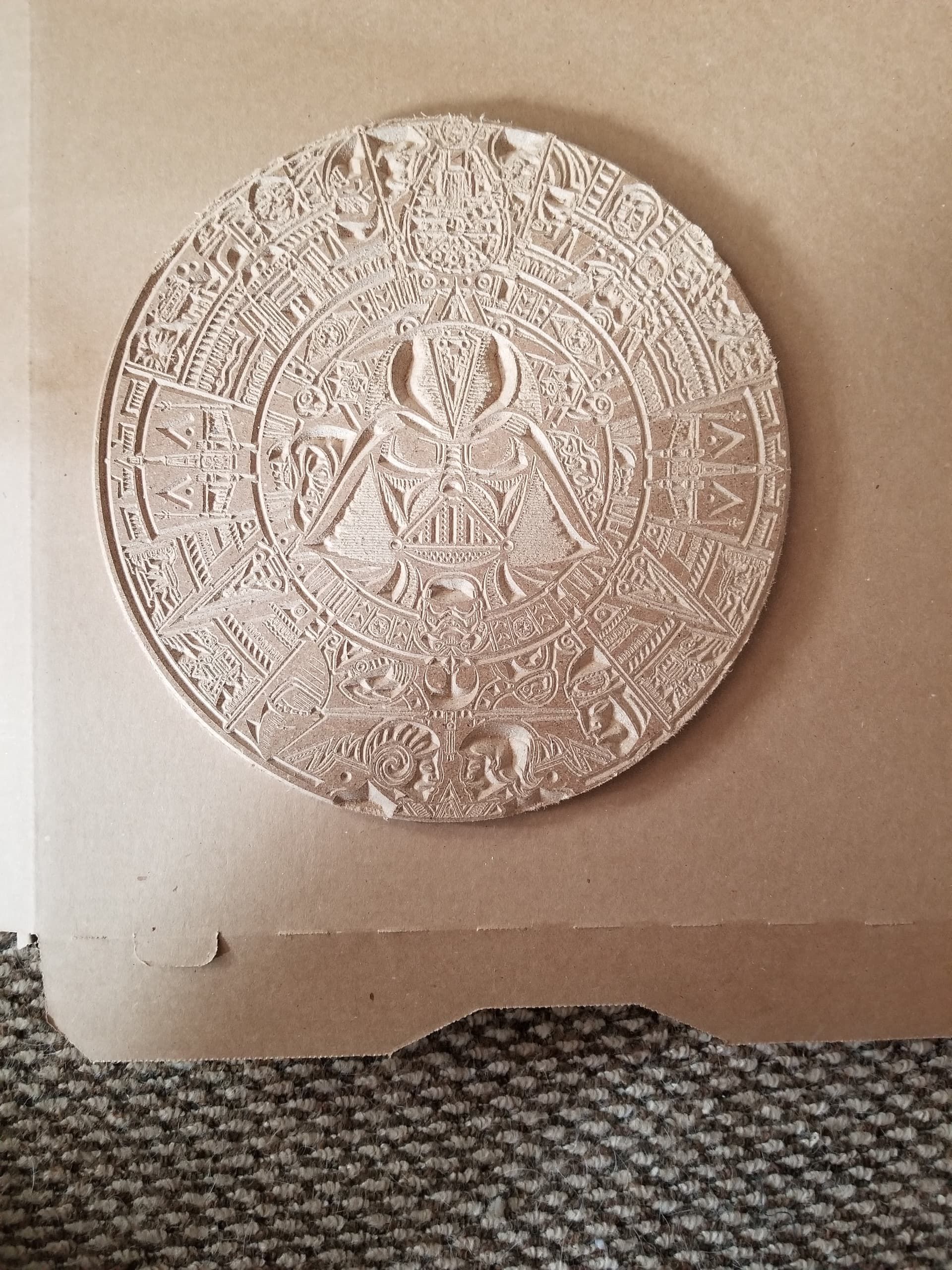

Almost have this thing ready to rock thanks to everyones help here, so first let me say thanks!
The last issue that seems like an issue is that the cuts are getting less accurate. Thursday and friday i did a few Marvel Aztec Calendars and they seemed to have great detail during the engrave. I went to cut the profile and the cut was a good 1/4 inch off by the time it got to the upper right (furthest from 0,0).
The next one was alottle worse. The third one was a lot worse and that upper right engraves were super messy while the closest to 0,0 looked great, so i am thinking something is off.
I rechecked square, added more support underneath in case it was sag, adjusted the wheels again.
Same thing today.
Any ideas?
I’ll include a pic when i get back to my shop
Here are some pics. The half finished vader face one is probably the easiest to see te detail and was the last one i did. Upper right the ewok face is chewed, and the border gets thinner as it goes upper right
The completed cut you can see how far off the profile cut is.
Since it seems to equally affecting x and y is it a controller issue. Im assuming it mostly equal otherwise it would be oblong on the x or y but not both. Rules out the motors, frame, alignment, etc too.

@Pkaser I have a bit of a hard time telling what’s going on with you carve since it’s pretty busy. Also, is this one toolpath or two or ?? Is just one tool path offset from another? In other words, did the Vcarve run properly and then the profile cut go wonky? More info would help.

I get that its busy but it shows how more precise the lower left cuts are vs the upper right cuts. And strangely, it started at the upper right and cut lower left towards the end.
2 bits, a 90 vbit for the engeave and a 1/4" endmill for the profile.
First cut was better and only showed the profile was off. Engraving looked pretty good.

I think its my spoil board. Its super humid here in Ohio and it appears my board has swelled a bit, and unevenly at that. Or its shifted and has a small bow in it now.
As you can see the 0,0 bottom left is low and it swells as it moves right and back, just like the sloppiness , so that makes sense. Board swelled, raised the piece, bit stayed at its correct height but sunk deeper in since the work was raised, causing wider than desired cuts. (Just spelling it out for logics sake.)
I also bet the profile being off is something simple, like the bit diameter being off by a fraction of an inch in vcarve. By the time its at the upper right corner it’s off by a full 1/8 of an inch.
So as i said i surfaced it just a few days before this issue, but over the last few days it must have changed because here it is mid surfacing and you can see the elevation difference pretty plainly.
