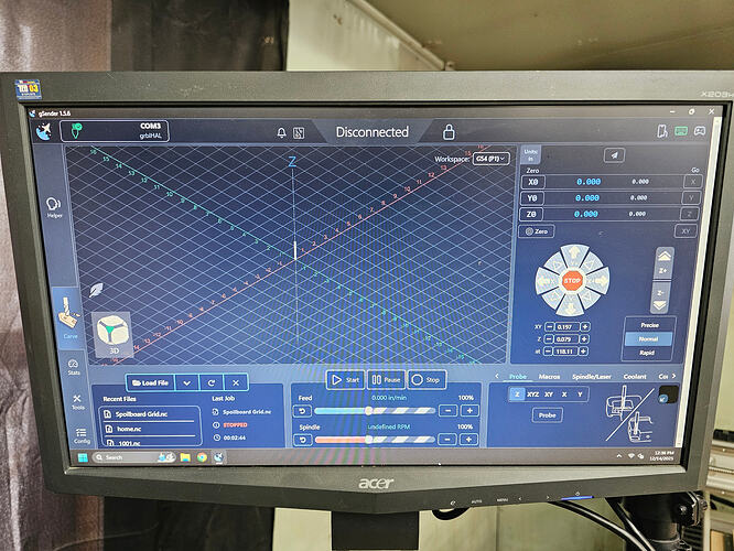

My altlmill has been running fine for one day. I go out this morning and the second I start a job, any job, I immediately get alarm 14. Spindle begins to spool then shuts off. Clear alarms and machine won’t jog (if it does, i lose control just after and have to hit e stop because it just keeps going). Power cycled, reconfigured, checked everything, went through all of the initial setup steps from sienci, checked drivers, updates, different usb cables (since I cant seem to get ethernet set up yet) (and probably some other things I did that I cant think of at the moment) probably 50+ times in the last 5 hours. Its the same every time. Code 14, then loss of connection. Though the drop down says its connected. Click to disconnect and reconnect then it says unable to connect and the power cycling starts over. Am I missing something??
Windows 11, latest Gsender version
Everything worked flawlessly yesterday when I finished the machine.

Still nothing. I went through everything today. Double checked everything, proper power cycle. Ran the configuration. Im getting alarm 14 immediately apon any command to spool spindle (though it does spool to a low rpm before shutting down a few seconds later) followed by an Error 1 - Expected command letter, which i dont think i noticed before :thinking:.

The time is milliseconds at most that the alarm is triggered. Immediate upon all spool commands. Even though it partially spoils maybe to 200rpm. Spool happens after the alarm.
