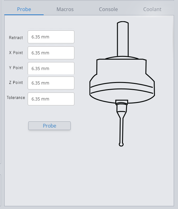

I’ve recently gotten setup to compile GSender and was able to package it as an executable today, so I am starting to think on a potential capability I would like to add. I have a 3D touch probe and one of the things I’d like to do would be to key in a known X, Y, Z point where I expect a part or fixture to be along with a tolerance (how far off that point am is acceptable) and using a retract height (z) move to the location and probe to confirm.
Now, I realize this can get tricky and one could easily crash if you are not careful. The thought is there needs to be an approach distance in which the machine needs to slow down, and then do the fast touch/slow touch from that position. This would allow fast movement to what should be a safe point to probe from, followed by the actual probe.
The main difference here would be this would not reset the X, Y, Z since that’s not the purpose of the probe. Instead if it ends up probing outside of the tolerance specified, or doesn’t probe at all, it could alarm. Although I’d like to add a find center of radius feature as well.
Anyway, just looking for thoughts on how you might like to see a 3D touch probe implemented in GSender. Some of you are probably using macros to do this sort of thing, but personally I would enjoy the ability to use the probe for such sanity checks, under the probe panel in the software.

XY probing is relatively straightforward but I would really like to be able to use it for Z as well, in a way that integrates with the fixed position tool height sensor. I’m thinking there are two basic possibilities here: (1) gSender could know the fixed Z offset between the tool sensor trigger point and some other fixed location on the machine (like the machine table surface). Then you could 3D probe Z on both the work and the machine table and calculate the “initial tool length” of the probe.
Or, (2), I could make some sort of physical contraption to repeatably register the 3D probe to the machine spindle nose. Then gSender would have to know both the absolute Z coordinate of the tool sensor trigger point and also the “tool offset” of the 3D probe. That seems like an ideal solution for ease of use, but it also seems like halfway to a full tool offset table implementation like you would want for a machine with an ATC or some other way to repeatably mount tooling. Which would certainly be a nice feature, but perhaps quite a bit of scope creep vs. other ways of integrating the 3D probe.

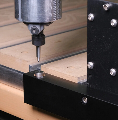

For Shapeoko the bitsetter is designed exactly for that purpose. That’s more for tool changes during a job and is really a convenience and I rarely use it. It looks like this:
Personally I would set my X,Y using the touch probe, then set the Z after changing to the tool manually. I find that to be as fast and reliable for me as trying to use the bitsetter, and to use the bitsetter with gsender you’d have to use a macro (someone posted a macro on here for it).
So a couple thoughts on what I think would be useful to most users.
  1. Set X,Y origin to center point of radius. This would allow you to probe the inside dimensions of an existing artifact on the part and set the X,Y origin to the center of a hole. This would probe four times and require that you place the probe into the hole before probing.
  2. Verify stock alignment. Let’s say you have mounted a stock board that is 1" thick, 12" wide with a length of 15". This could probe the first corner XYZ, then probe the opposing corner XYZ, and alarm if that corner is not in the expected location.
Just two things I thought of. The touch probe is certainly the type of probe that would have the most scenarios associated with it so coming up with UI that makes that easy, and useful, will be the challenge.
Center point finding of a hole would definitely be useful. Or the center of a slot, in the one-dimensional case.
I suppose I should mention that basic XY probing seems to be working fine when I set it up as a “standard block” with XY width of 0 and a tool diameter equal to the diameter of the probe tip ball (2.0mm on mine).
Yep the corner probing works fine for me too.. XYZ using the standard touchplate and adjusting the tip diameter to 2mm as you said.
