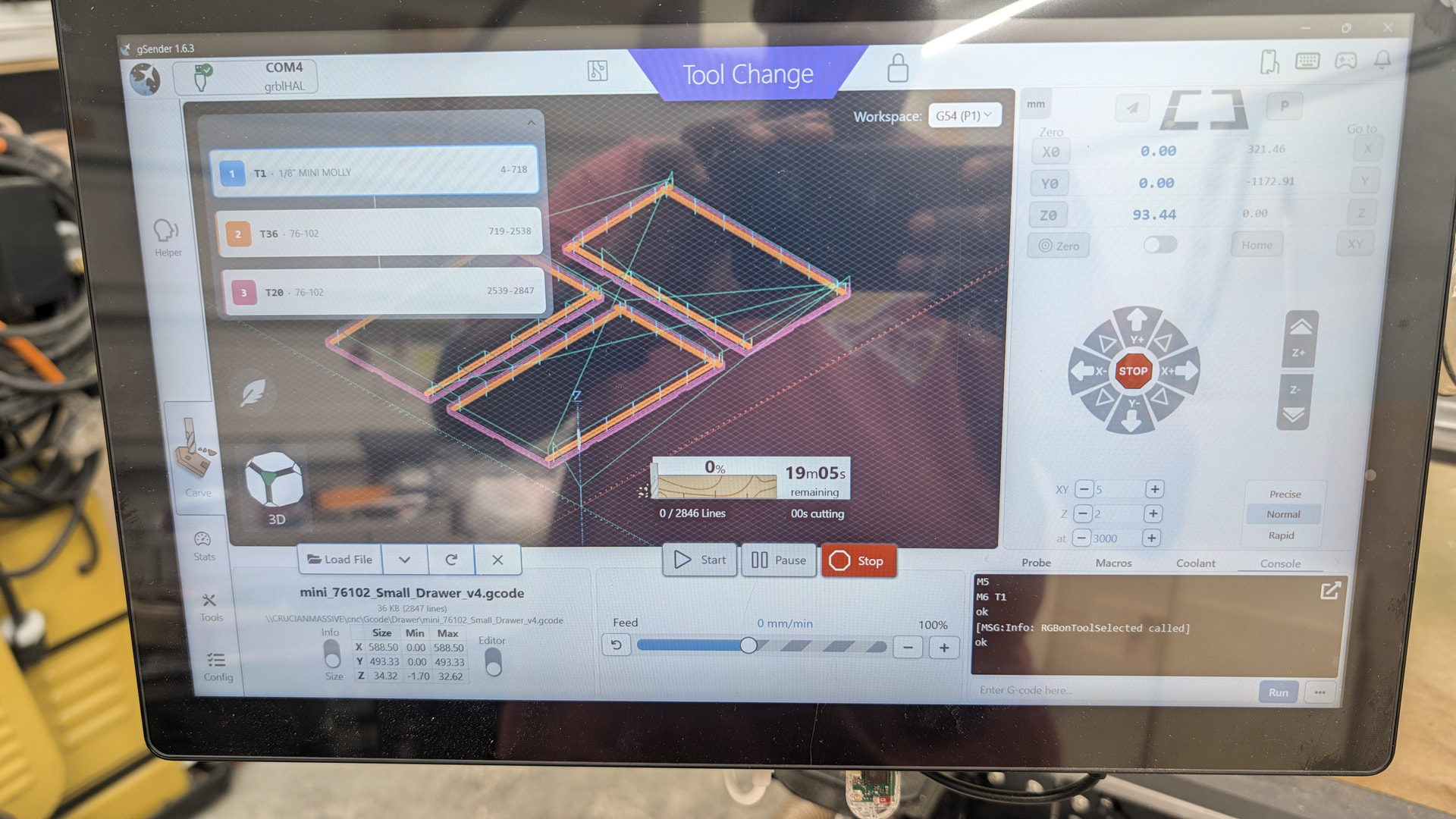

I have run into an issue on my second card where the TLS prompt goes into a loop.
gsender version 1.6.3
SLB version 20260525
I also installed the new post processor in the post below, but gsender is stuck on the tool change screen.

The issue is now resolved, support reached out to me and I installed the Sienci Labs TC (GRBL)mm post processor
