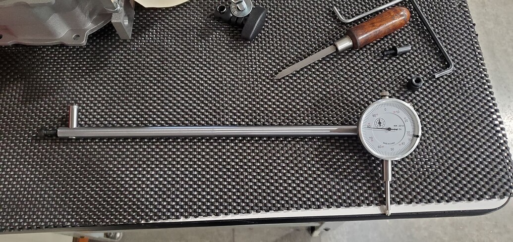

Jo Beerbarrel,
I am a bit shocked you are calling for an Eddie. Everybody knows Eddies are not famous for being the most reliable partners when it comes to doing things the right way. We cut corners around molehills.
Especially tramming. My machine, has no clear option to tram and I am not really caring for it either. I surface at a 45° angle and I am seeing that due to a wee slop I get ridges. Instead of correcting the slop, I just invert the surfacing angle and run the too path again creating a nice pattern. (Itll sand out.) So, not realy the guy to call out for.
I can theorise with you about howto go about this molsmountain you have though. If I would have a wasteblard I needed to surface, I would want to do that only once. That means it needs to be trammed before surfacing like IDC states. I would however first surface a piece of waste-wasteboard ontop of the waste board to see if my tramming is indeed on par.
There are tools specific for tramming and I think that if you are going to do something, it needs to be done right or close to right. So maybe research the tramming process first before engaging your main wasteboard and go with the secondairy wasteboard option untill you wacked that mole?
Sorry I can’t be more usefull.
Though not about the altmill, this topic might give some general idea on the process.

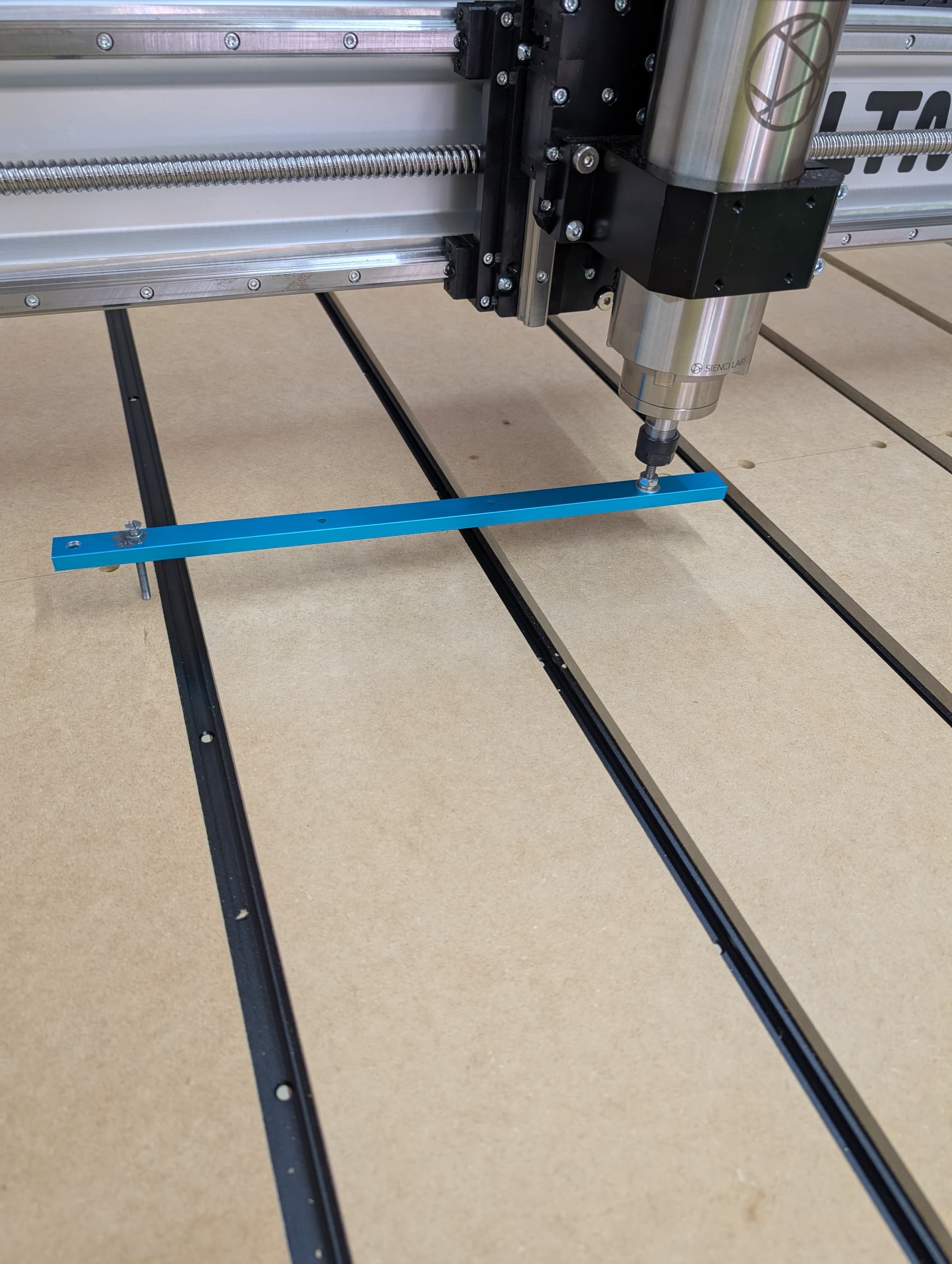

While I eagerly await my tramming tool, I constructed a rig to help me check the measurements. From side to side I am dead on. From front to back, Im about 30 thou out. That is like .78mm. That is over a 24” diameter circle. Do you guys think It is time to just go ahead and surface or try to get it closer before I do the first surface?
thx,
Tracy
My makeshift tramming rig
Lets do some math and see if I remember how to do it. Let’s try to figure out how big the ridges would be with a 1/4” bit.
30/24 = x/0.25
x = 30/24 x 0.25
x = 1.25 x 0.25
x = 0.3125
That means, if my math is correct, that you’d be off by 0.3125 thousands over a 1/4” or 0.0003125” if you prefer. You’ll probably surface with a bit bigger than a 1/4” but it’s a popular size for actual work which is why I chose it. Just replace 0.25 with your actual surfacing bit diameter to get the number for your surfacing bit.
Maybe that will help you make your decision. You likely can get closer if you have a way to correct the nod but it’s not as bad as it first appears depending on your use case. Metal vs wood vs ? For woodworking with a 1/2” bit or less I think your already at a point where not too much sanding would be necessary. It could be that we CNC woodworkers exaggerate the need for perfect tramming a bit. That said I’m all for doing your best!
The only fly in the ointment is that you are trying to tram against an unknown surface which is an approximation. Normally tramming would be done on a mill where the mill table is known to be flat and the mill’s head is trammed to the mill table.
Even if you were to surface the table and then put a granite surface plate on it and did the tramming on that, you still have the potential for error.
I would mount my normal surfacing bit run the routine and then look at the result - does it look (or feel) like you want this to be improved? If a quick sanding would fix the issue I would not bother keeping in mind that something as simple as a humidity change can screw things up.
The only time you can even see this kind of an error is when you surface things and how often do you do that? If you said ‘I surface cutting boards all day long and have to manually sand them afterwards’ then it might be worth it (or get a good wide belt sander)
I would like to add that from past experience, if you try to improve ‘good enough’ you can end up screwing around for hours and never get it quite 100%.
