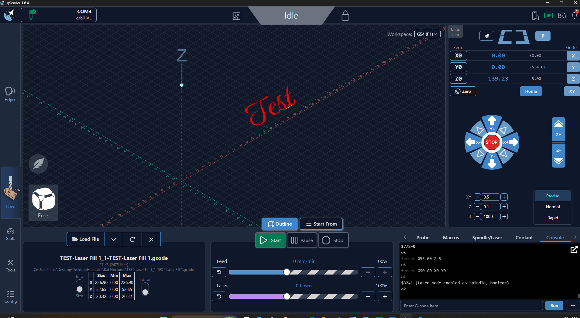

So Ive spent a fair amount of time trying but am stumped. I would like to stop the Z from changing while running the laser on my Altmill 2x4. It was working fine by now turning on laser until it hit zero but now that I updated the gSender it turns on while dropping causing the laser to burn. Comments appreciated.
Are you sure that gSender was in laser mode in the spindle/laser tab?

You can confirm that the UI toggle is working with the console. Entering $32 should respond with 0 for spindle mode and 1 for laser mode.

Thanks everyone for the help as I’ve lost production time trying to figure this out. Yes, its in laser mode yet I find two things odd, 1-The Laser offset function doesn’t do anything when trying to use offset to accommodate the laser head position and 2-Laser on Outline wont work either.

Thanks to everyone for kind and helpful input, its refreshing to find others that understand what we go through. The good news is that I finally did figure it out and one of the issues was in assigning a seperate spindle to act in place of the laser and when it did it chose PWM vs PMW2. Seems that a dedication LASER option would make more sense. I was also able to change a number of variable based solely on that spindle option to get it to stop jumping Z so Im back to work and if anyone else needs to ask on variables feel free.
