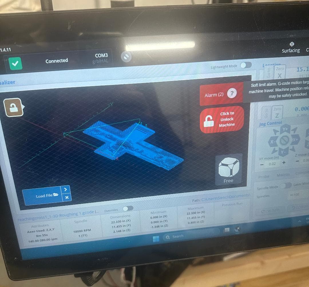

So i just got the Atmill back together connected to Grbl Hall, created my V carve pro 3d carve as i did in past. Used a USB drive to copy and the take to the G sender computer by Sienci as i open it and tried on all the roughing, finishing as well as profile. Lines up outside the material limits as shown in the picture. What am i doing wrong? It was created fine on V carve. In fact the 2nd project unrelated did the same thing. Must be a setting.
The alarm says soft limit exceeded so either the settings for gsender xyz soft limits are too small or the project is too big… most likely the former.

Hey Michael thanks for the info. Just reporting back. $13 is off as you stated and $130-$132 are listed in millimeters. I checked my post processor and made sure i resaved in Grbl ā€˜mm’. Still the same. Not lining up correctly. Not sure if i should reinstall g sender.
I’m not clear on what this statement means. I put my gSender in inch mode and one square on the grid is 1". I counted 23 squares for the X axis and 11 for the Y axis in your picture. I also see that your machine and workspace coordinates are the same for the two axes shown. So I’m assuming that you just homed and the project is 23"x11" so it should fit.
Oh wait I think I might have figured it out! It looks like the front of the carve is right on the front edge of the machine. I’m thinking the blue in front of the X axis only appears in front because it’s below with the grid on the top of the carve. If your XY zero is set to the bottom left corner of the machine the bit is probably running out of room at the front of the machine. After homing the machine try jogging away from the edges and setting XY zero there and see if it fits then.
I hope that’s it!
EDIT: Silly Michael! The dimensions of the project are in the picture, I sure took the long way to finding them out. I still think the problem could be that the XY zero is the same in work and machine coordinates.
EDIT2: It’s the Z axis that’s the problem. I was looking at the X and Y and they go to zero but not beyond but the Z axis is set to zero at the top of it’s range and it needs to go between -1.348" and 0.8" and it can’t go above 0". I gotta say I feel a bit like Sherlock Holmes on this one! :wink:
Be aware that the XY might not be the problem on this carve but they might be on the profile cut because the bit needs to be outside the cross by half the diameter if cut outside the cross.

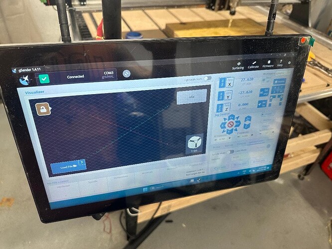

Thanks for the response, It looks like all settings are correct, what happens now and it may be related that no matter where i am on g sender and trying to set XY zero the button does not respond and it doesn’t allow me to set the zero nor does it let me set the Z either manually nor with the auto Zero touchplate. It seems all may be related. The button is grayed out on both. Very odd.
:cry: It seems we have problems under problems. :cry:
I just noticed that the location area in gSender in your pic looks too big for the area it’s in. The ā€˜Go to’ and ā€˜Zero X’ should not overlap the ā€˜Location’ heading. So maybe it’s worth a shot to reinstall gSender.

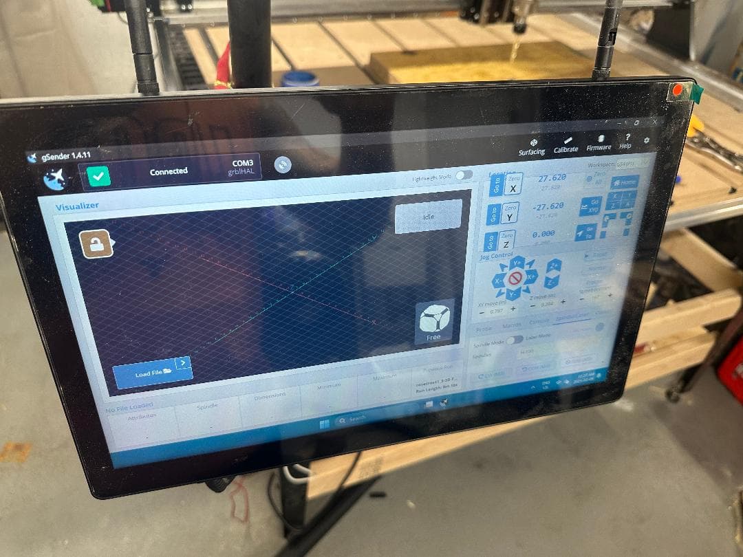

I cant even use the auto zero touchplate because it indicates waiting on connectivity but nothing occurs. Spindle turns on and off i don’t know if there are any other settings left. I am on COm3 Grb hall as you can see in photo. Should i reach out to Sienci directly.
Yeah, I think it might be time to get help from the pro’s. Here’s the link if you need it.
EDIT: The only thing I can think to try, and this is grasping at straws, would be to download a fresh copy of gSender from GitHub and do a clean install with that. I don’t have high hopes but it’s the weekend so I’m guessing you won’t get an immediate response from Sienci so why not try. This would be just in case your previous download got corrupted some how.

Point taken but i initially input the size of the project as i have done in the past and then copy to USB drive and transfer from the C Control computer and open g sender and load each tool path. Why is it not allowing me to zero on my material surface and greying out as indicated on the picture Makes no sense.
@Nbase1 I’m not sure if this was addressed to me. I’ll reply, but then others can also.
I didn’t mean to say that you cannot input the size of material in VCarve. In fact, you have to. I was only saying that the size of the material is not part of the gcode. So, it is not part of what gSender sees.
I can’t see the greying out that you are talking about. When you say ā€œit is not allowing you to zero on the materil surfaceā€, what is ā€œitā€. If you mean gSender, how are you trying to set Z0?

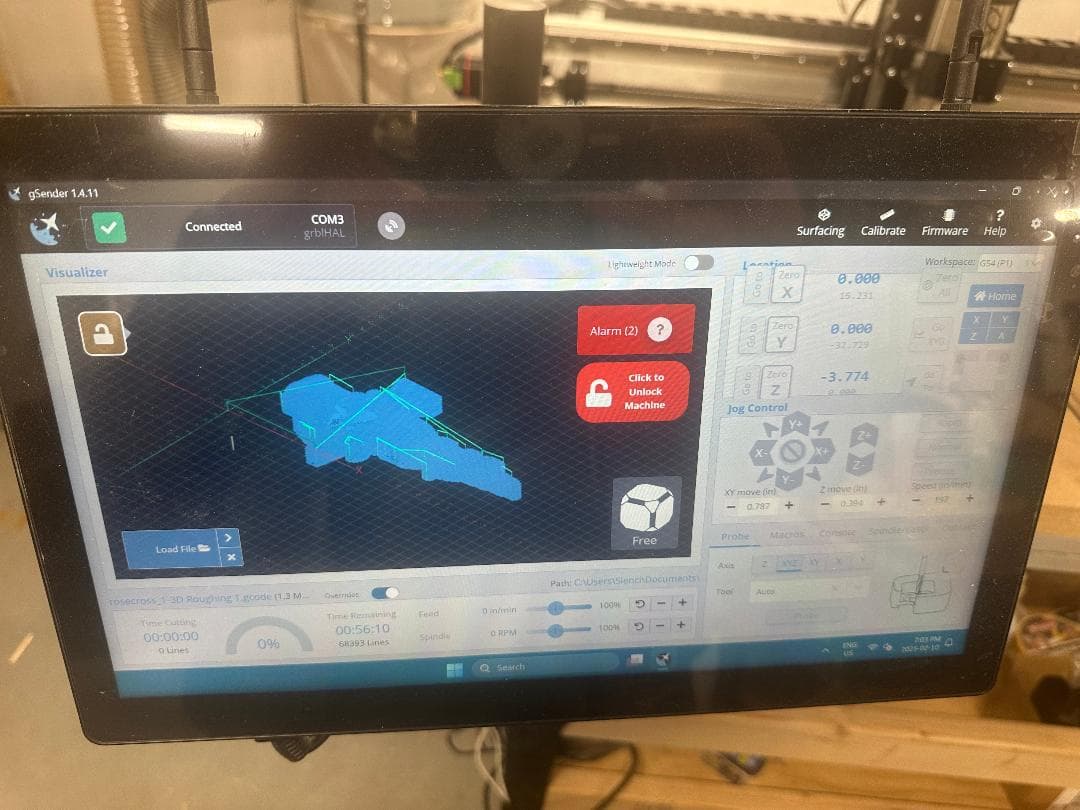

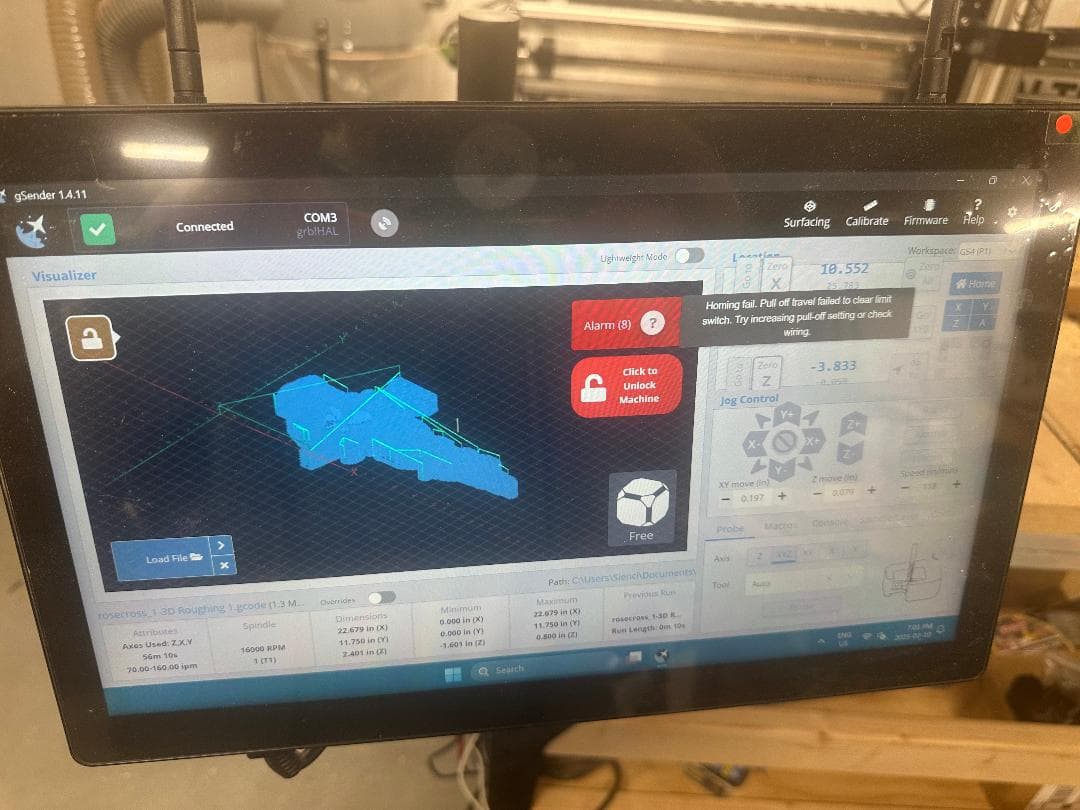

Hey Jason, thanks for the response. I got it to work and start carving, then 2 minutes in my z went idle after a small gouge and just started going back and forth without any movement up or down. See video and photos with the 2 alarms. Before all this it use to do the same. Any ideas as to why all loos good, no movement on the endmil, or loose screws. I checked everything. The gcode looks ok as well.

I would say that you should open a support ticket with Sienci since no one here seems to be able to resolve this. I see that the error you are getting relates to the pull off setting on your switches, so you may want to try addressing that. I don’t use switches so I’m not competent to advise more on that. The link that you included is some kind of reference page. There is no video that I saw.
This is the first time I have seen that you have gotten alarm 8. I don’t know if you’ve been getting it but it means that you have to increase the pull off distance in the firmware, I think it’s $27 homing pull-off in mm. Either that or home slower if your homing at a fast feed rate. The pull-off is to get out of the range of the sensor so it reads off. I’m guessing that homing fast might need more pull-off because the machine is traveling some distance while the signal from the sensor is sent to the SLB and the SLB stops the motor.
The homing cycle should travel somewhat fast to the sensor and then back off and go to the sensor at a slower rate. The fast part is so homing doesn’t take all day and the slow second part is for accuracy.
When you get this alarm the machine has not homed properly and it might affect further operations like setting zero.
