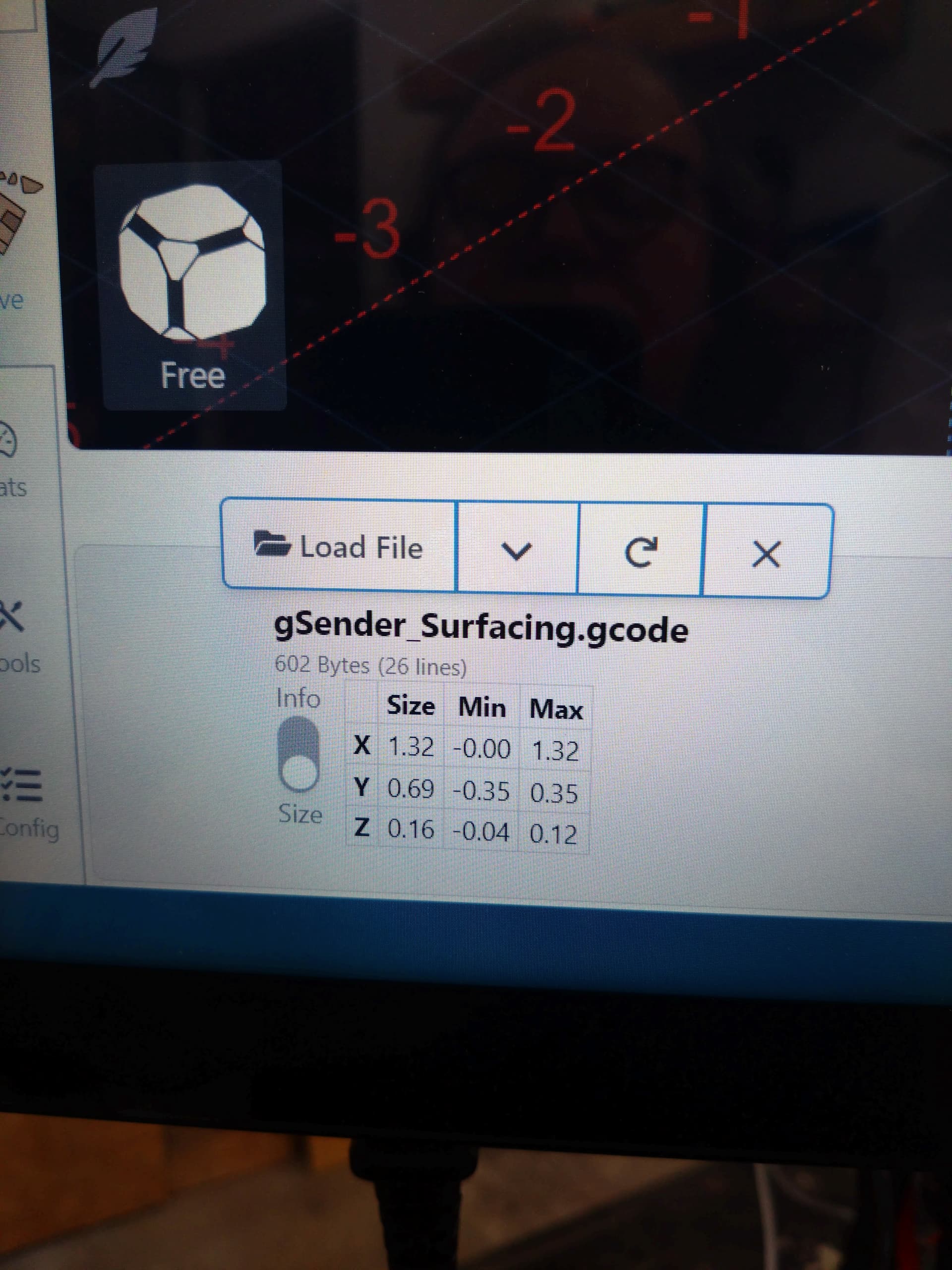

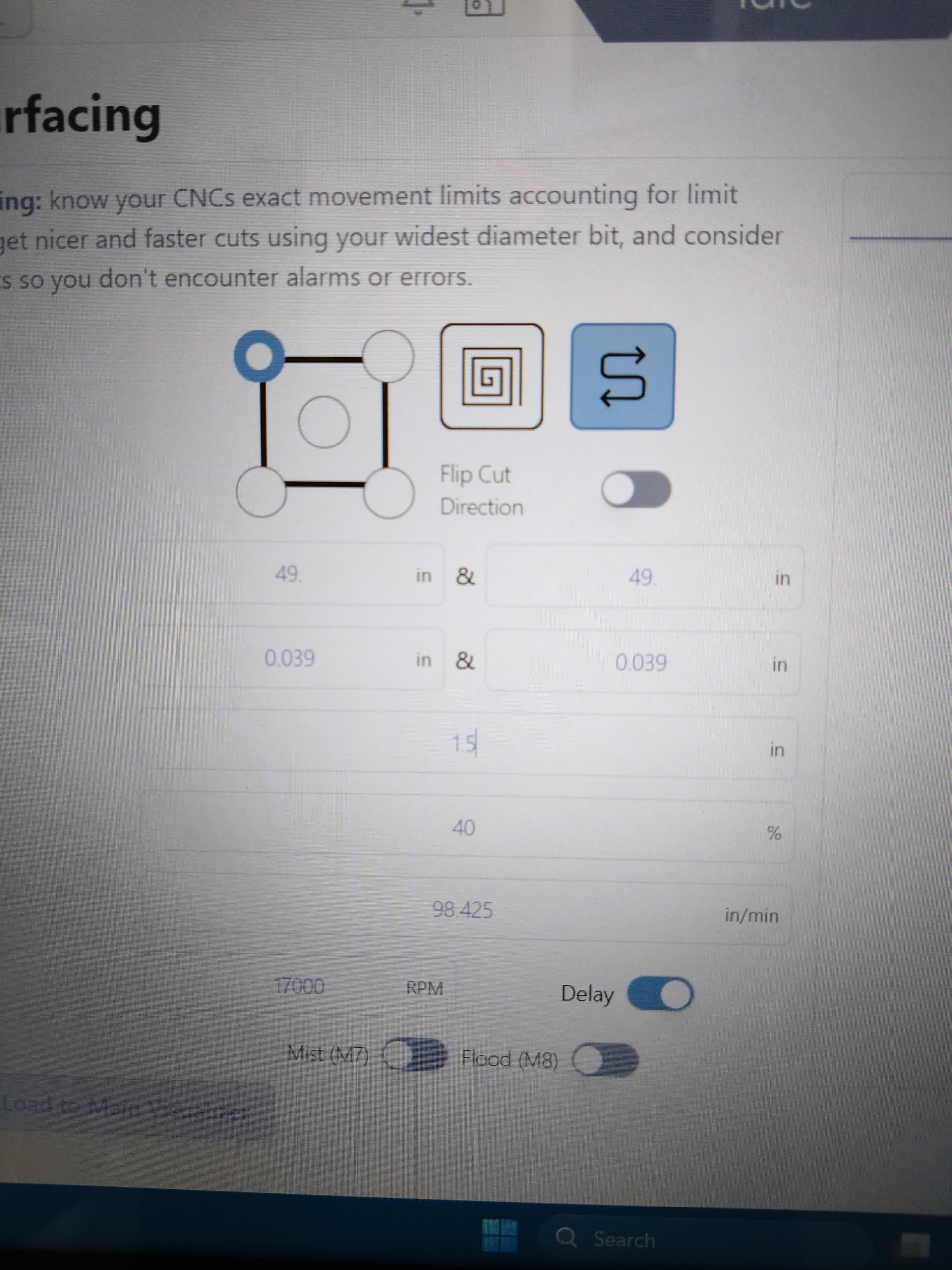

attempting to use the surfacing feature in gsender.
i set the size to 49. x49.
the bit is 1.5’‘ and when it generates the gcode its for a very very small area. what setting am i missing?
i tried using carveco maker to make this happen but the altmill gives me a soft limit error. so i am going with just one problem at a time. i want to make the surfacing option from gsender work. point me in the right direction?
@courtney There is a known bug in the surfacing tool in 1.5.5. You can read about it here

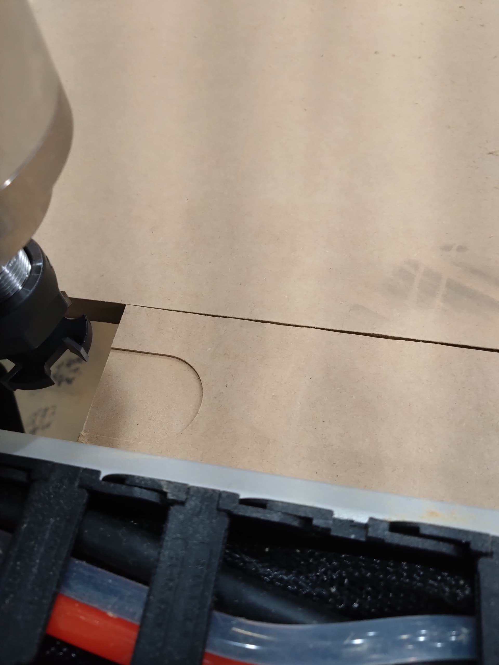

thanks. i guess i will move from this problem to the next one. the soft limit error when trying to run a surfacing program from carveco maker +
Sounds like you run into the same problem discussed in this topic. (A few posts down - settings carvecomaker)?
Never mind.. that is you too. :rofl:
yeah. i had to relearn how to make the files. offset on the material set up. starting position. all reverse of what i got used to. but i got it running. also having to adjust the hold down methods as the altmill is a lot more powerful and will happily sling your work piece all over the bed if its not super secure.
